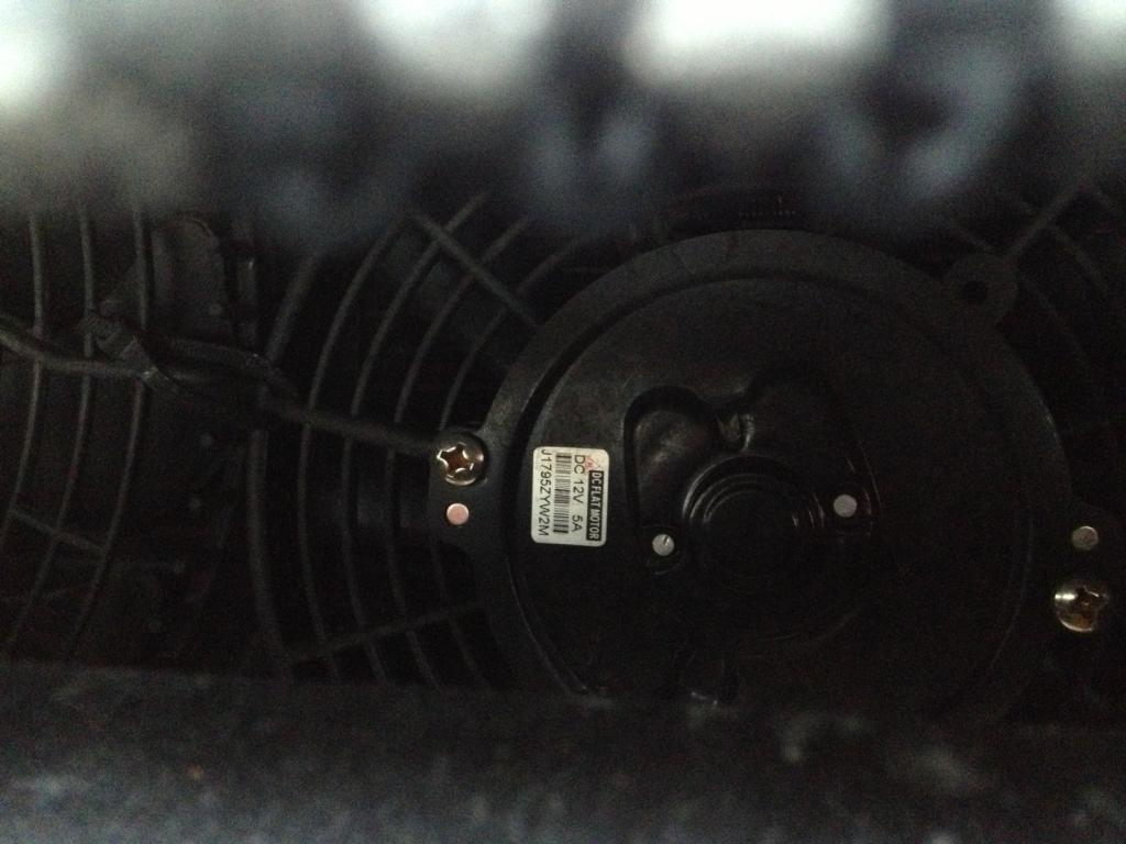

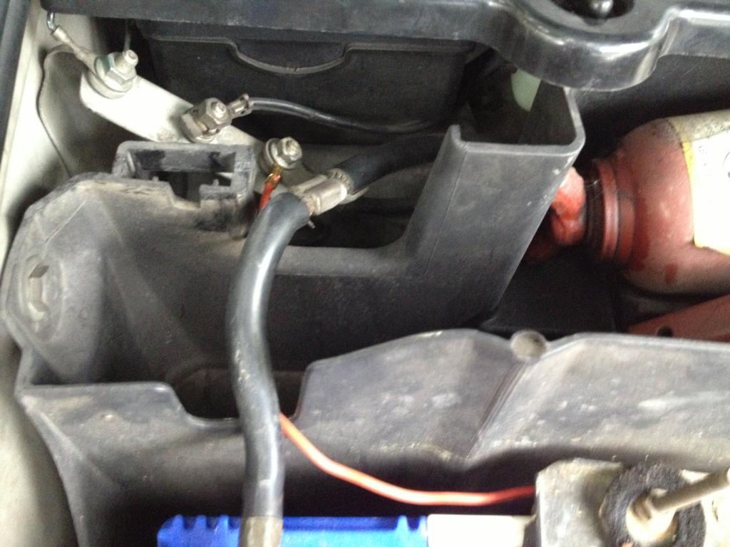

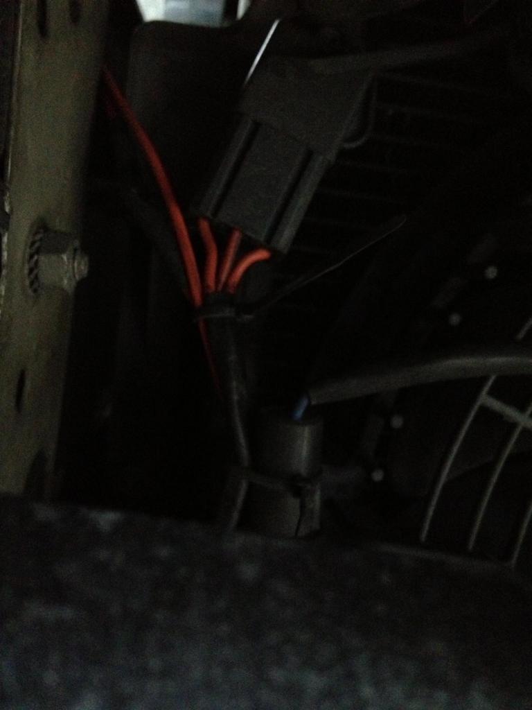

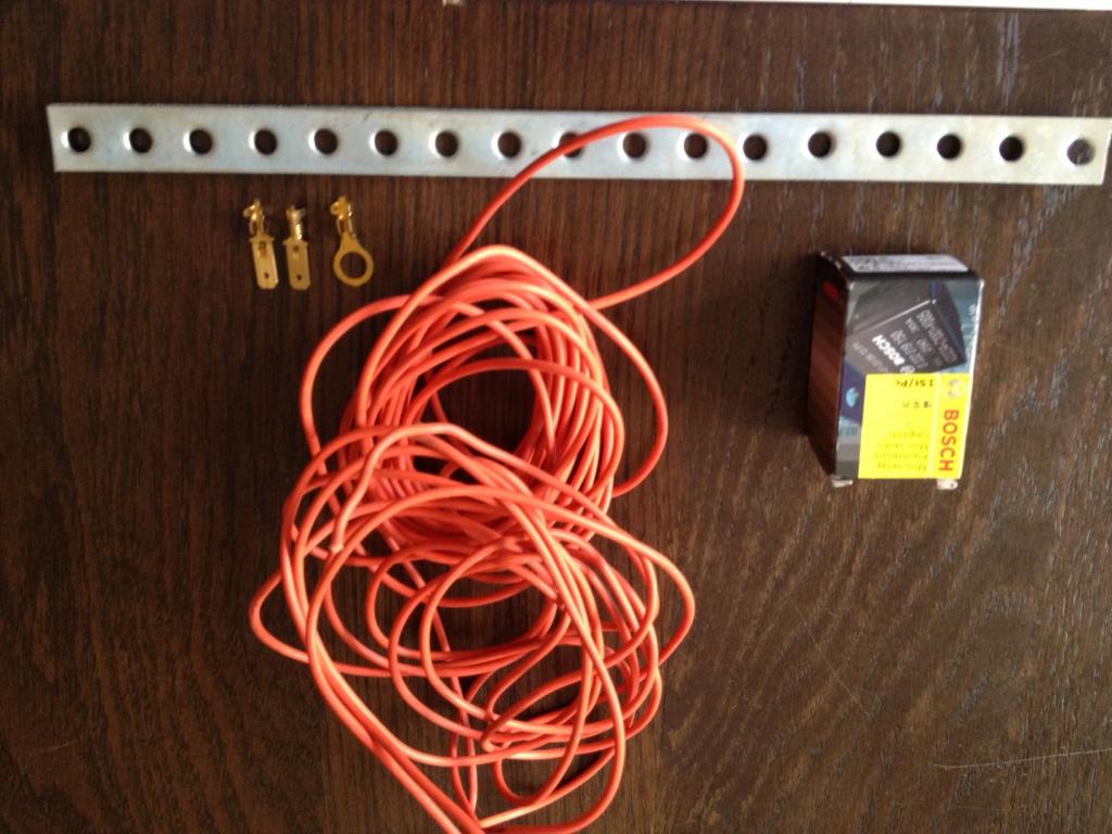

Here's the pix, unfortunately i did not took the pix while installing this, and as i have also install headlight guards it a bit difficult to take the grill out, sorry for this!
What missing from the pix here are 8" universal fan and 30 amp fuse and housing
Wiring one to battery one to ground,
Fuse housing and relay tired up next to existing fan as there are space available.
New fan on the right
This is how I tired the new fan to the existing air con condenser frame
Hope this help! let me know if you have any questions
