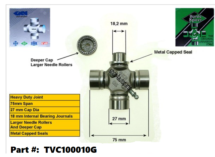

IMHO spend the few extra dollars and get the GKN HD's ( TVC100010G ) with the metal caps.
> https://www.lucky8llc.com/products/r...iversal-joints

So I replaced the rotoflex (GKN, made in Germany) and the U-joint. Getting the shaft out was easy, U-joint too. Getting the new U-joint (TVC100010G) in was a PITA, one cap cracked when pressing it in. I had to get a replacement quickly, only option was O'Reilly (Precision). I sanded the holes with 1000 grit sandpaper, but the new U-joint got stuck again. It came out easily, so sanding again and finally got it in.
was very helpful, especially the trick with the hammer to get it set in correctly. Took a test drive, no vibrations and after a 600 miles trip, no issues.
