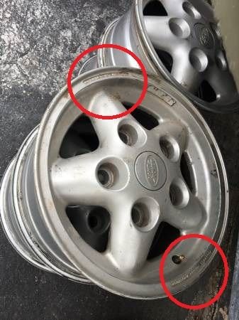

+1 those will fit a DI.
If you want to be sure, or if you find more rims have the sellers give you the part number it's stamped on the lip.
See the pic, it's either in one of the circled spots.
