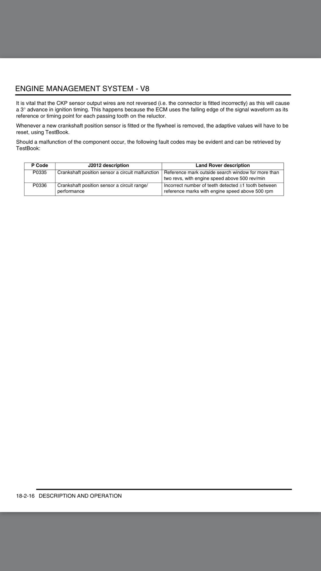

Are you using the 18mm spacer for the sensor?

Old Feb 2, 2017 | 03:27 PM
Luckyjayb's Avatar
Joined: Nov 2016
Posts: 1,611
Likes: 112
From: Bham, Alabama
Old Feb 2, 2017 | 03:28 PM

[QUOTE=Luckyjayb;594680]
did not know that you are supposed to have the values reset every time you replace the crank position sensor. Anybody else had that issue?
