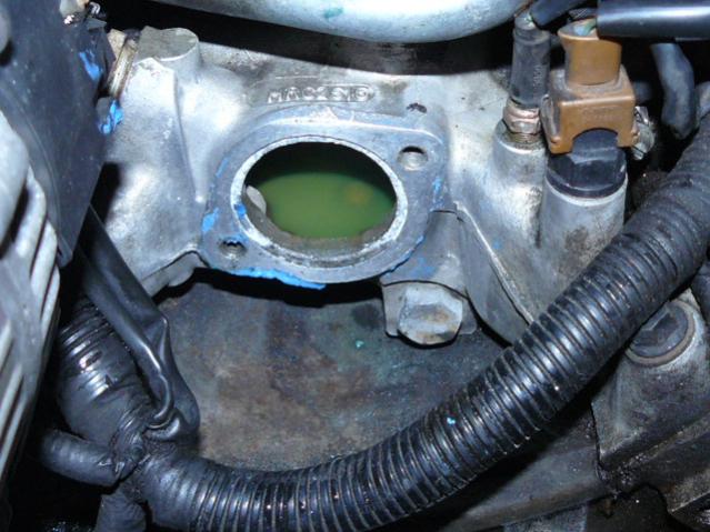

3. Let us leave the gauge alone for the moment. If the Autologic coolant temp reading and the IR of the pipe that exits the intake manifold are close, like within 5 degrees, I would believe them. The coolant sensor is very close to that outlet. Pix of same on a D1, you can see the location of the coolant temp, and just left of it the gauge sender (D1 has two on top). Point is that water coming through that spot is about as close to the monitored sensor as you can get.

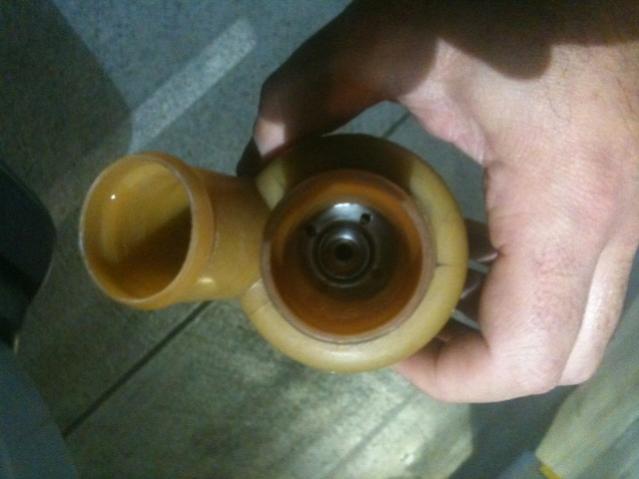

4. Water pump wobble would only have gotten worse, until it leaks, and eventually comes off with fan slicing radiator. Pix of old pump impeller (mine). When they wobble, internal spacing is small and they start eating aluminum.

Number one could be thermostat. It is remote from the block, and depends on hot coolant reaching it, mixing with radiator output, and raising thermostat wax pellet to 180 - 204 F. That remote metering is done by four holes in the top axial leg of the stat. Coolant at that point is flowing downhill. If flow was slow, stat would close up some or all the way, because it is not hot enough. IMHO the number of sample holes could be increased with a drill bit. May not be enough space to enlarge the existing. More flow through metering holes would reduce time lag. Ina D1, the whole stat body sits in the coolant. Pix attached. Sometimes these holes get clogged with coolant system trash broken loose by work. ould also think that air flow around all these parts can cool them off too far, impacting operation. Could be tested with some pipe insulation and zip ties.
