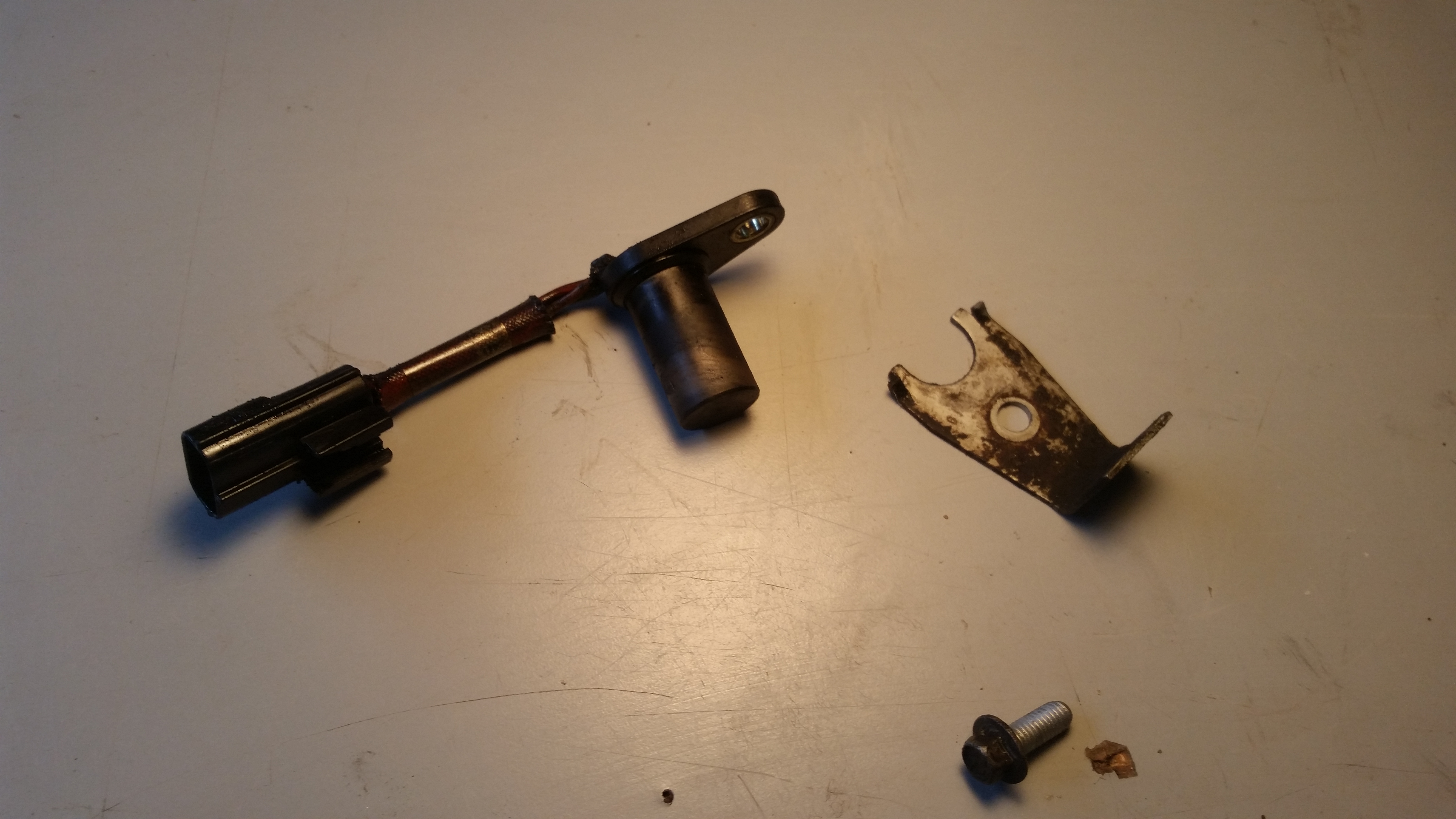

OK I see the o-ring.. its pretty crushed.. Ill see if this is the fix pretty quickly...

Ok, the cam sensor was not the leak.. So I guess all signs are pointing to the crank shaft seal?

I pulled and changed the camshaft sensor... now the truck idles like **** and is giving me a "camshaft" error on the CEL...
I ordered a new crankshaft seal so i will pull the pulley and make sure I have the sensor installed correctly when I do...
Could I have damaged the cam sensor?? I didnt drop or bang it on anything.. I carried it around like a full martini...

I've never gotten that error but the sensor is pretty basic. I don't think you could damage it, especially if you carried it like a martini. I've left them in the bottom of a toolbox for a year, gotten them wet, thrown them, then put them on an engine and had no issues. More likely the wires are the culprit.
