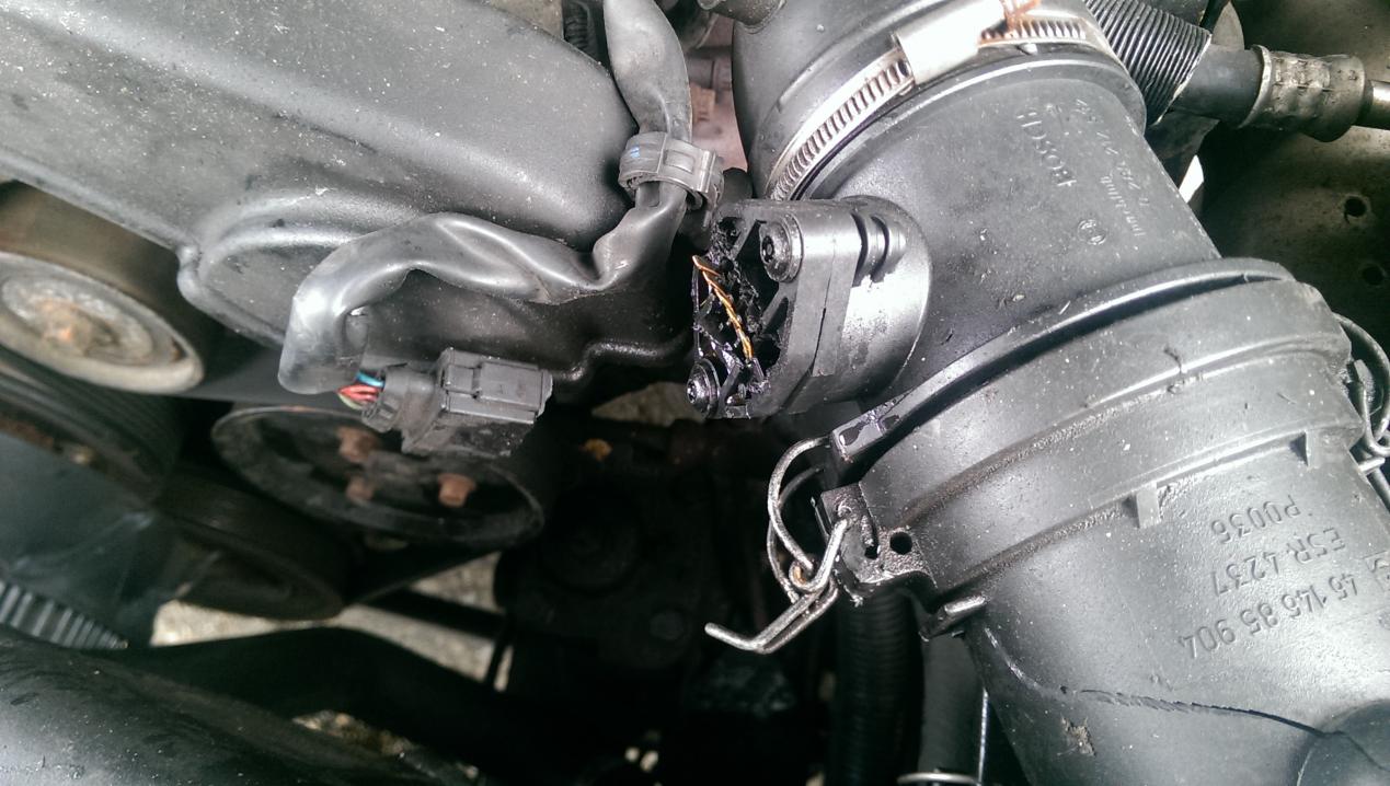

Hi Everyone,
my 2001 disco decided to celebrate our 1 anniversary of ownership by having the fan explode into bits in the engine bay. My son was driving the car at the time, he said he was at full throttle accelerating trying to merge when he heard a loud explosion and the hood seemed to want to pop up. He immediately pulled over and saw there was oil and water everywhere on the ground. We had the car towed back to the house.
I took the pics below to show the carnage. The fan blades took out the MAF, the thermostat and cooling hoses, and poked a nice gash in the oil filter which explains why the oil leaked out of the car.

6- MAF was Bosch and brand new. Connector is toast, but perhaps there is a way to salvage it?

Change only the filter, check oil level and fire it up. If no knocks, fix it. Will run rough or hard to start without MAF. But, this is doable, IF, he stopped immediately. I would fix it anyway, get more on trade or sell for a running vehicle. Check around for used parts but not fan.

Sorry but the MAF is totaled. PartsGeek has a new bosch MAF or $102/freeshipping. Are the plug and wires that plug into the MAF cut and destroyed also? They look good in the picture but I don't see how the MAF can take that kind of damage and the plug not take damage.
