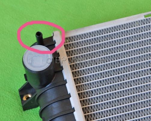

Well I spoke too soon about the radiator I think. I'm at work, so I can't double check, but while I was looking at hose diagrams online, I realize that nipple on top of the radiator for the hose that comes from the expansion tank is gone. The hose is there, the connector is severed. I'm guessing it snapped off. See pic below. No way to repair right?
Sorry man but the radiator is toast also.
This is why I added the radiator to the parts list. You would have been one lucky person to have the fan explode like that and the radiator not get hit with shrapnel. The good news it that you should not need to replace anything cooling related for a long time.
