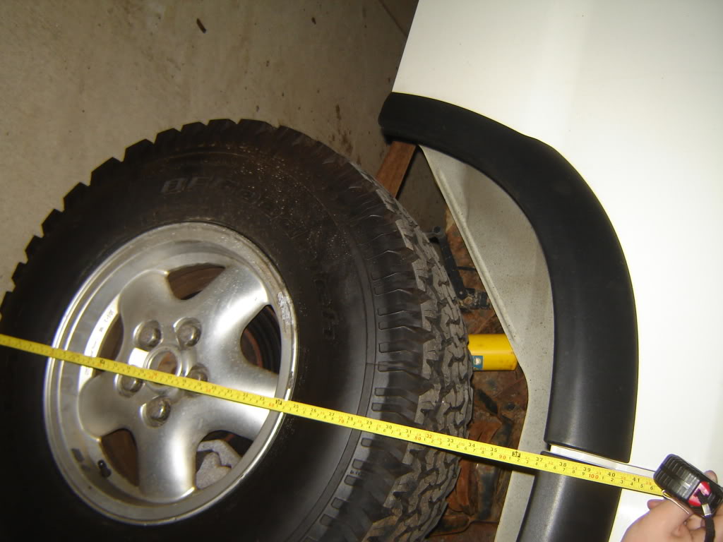

Mike,
I just put brand new BFG 265/75/16 on mine and i have the OME 762's. Mine sits at exactly 37". I have them inflated at 42 PSI. Reminds me of a question: They say max PSI is 80. What would you recommend for highway use?
Here's a picture:
