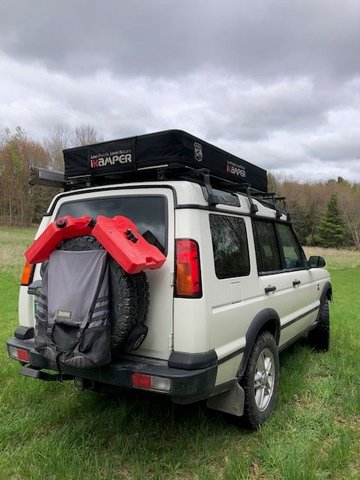

I mounted my Rotopax on my spare.

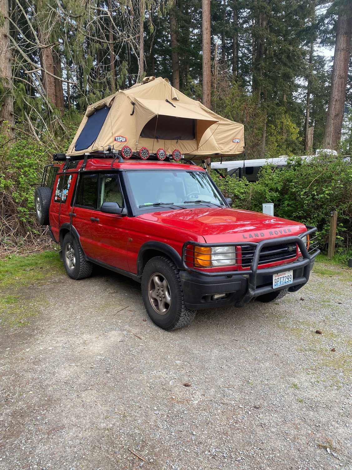

I have a 3 person roof top tent on mine, a small awning off the back, plus a small forward "roof rack" that's basically an attachment point for lights (but it could hold something if I ever wanted to put something up there). I estimate that I'm at 170lbs all in. I have the full length roof rails but lets face it, their old and I didn't like how much they were bending so a bent up a set of ladder racks which place the load of my roof top tent on to the gutter rail and now its very solid. I do moderate off roading with all that loaded up there and there has never been a problem and nothing has ever even so much as moved on me.
