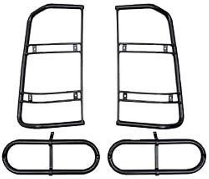

I believe this is the ones. I do not have the oval guards shown at the bottom

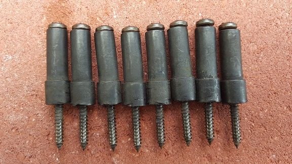

You need 1" longer screws than the ones already holding the light, also need 7/8" spacers to go between guard & lens,, I am sure you are missing those as well, just get some black plastic water line, & cut them to 7/8" sections & use them as spacers,, (You can get the water line that is being used to replace ice maker lines, they sell them by feet),

IDK the screw size, but the metal guards (VUB500680) also need the spacers
Have at it > https://www.ebay.com/itm/LAND-ROVER-...RZXyC2&vxp=mtr

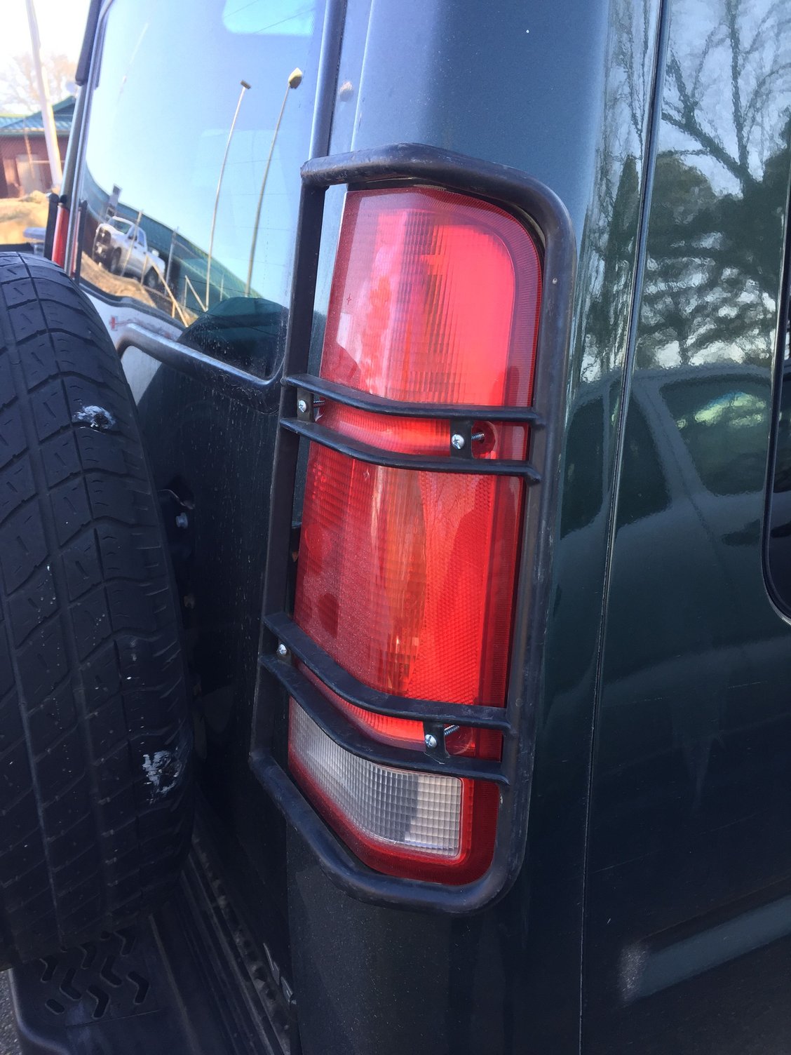

i found some screws that fit, did not have spacers. The holes barely fit the screws. Thanks
so much for help. Just put them on. I want guards for headlights now

Looks good!
