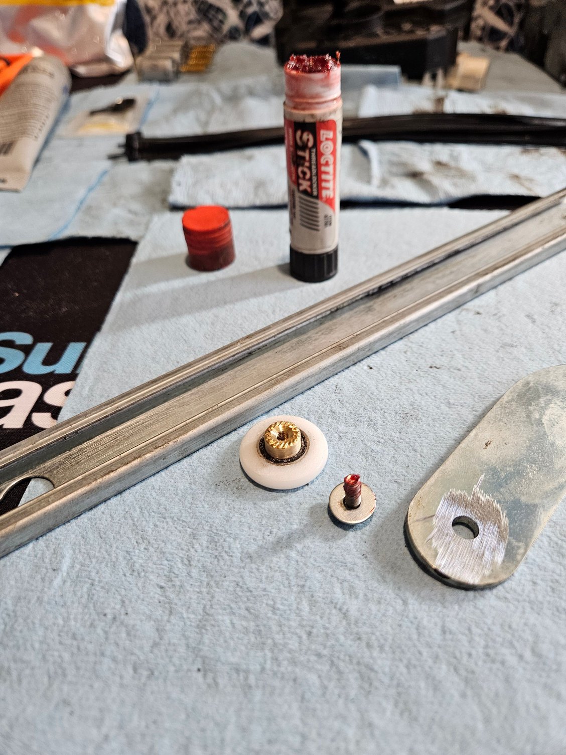

I found that with just a lil bit of sanding on the edges to thin the wheel down, the versions I link to below work really well. These are 25mm round and 5.5mm thick, but need to be 5mm thick, so sanding about .25mm off each side to bring the Delrin down to the surface of the bearing cage worked great. They come 8 to a pack, for $13. That's enough to do all the windows on the Disco...

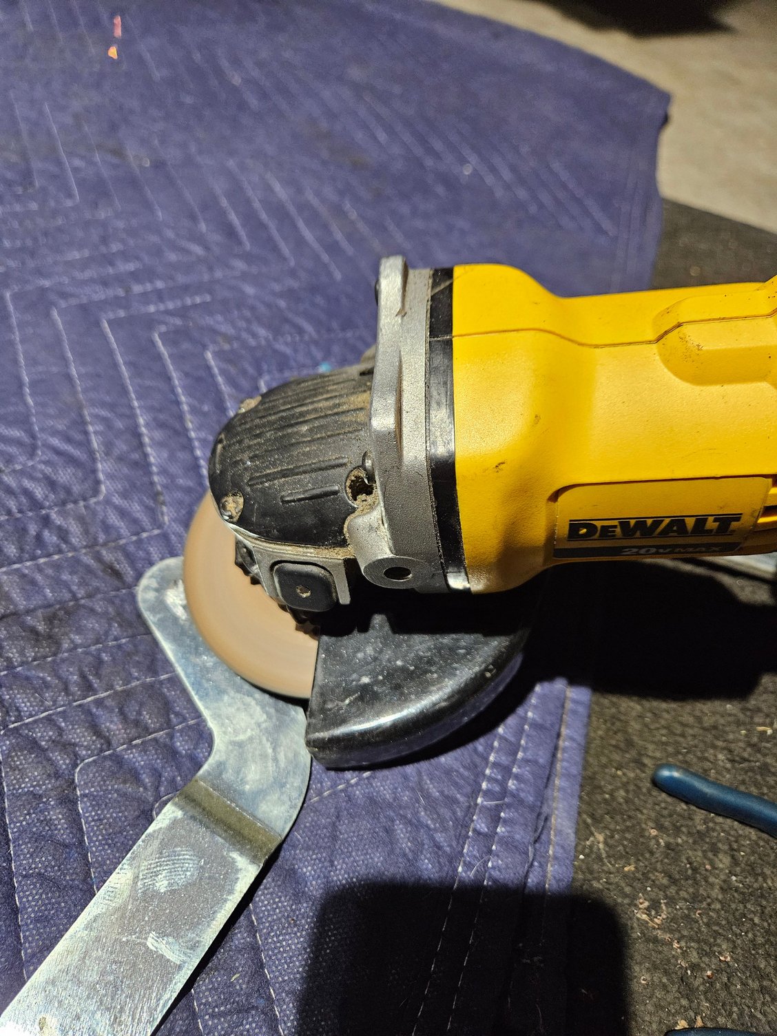

To get the old rollers off the regulator arms, I just used a grinder to grind off the head of the old roller, and tap the shaft and wheel out with a hammer.
Then I used a flat washer, a locking star washer (sourced from good 'ol Ace Hardware) and some red Loctite to attach the new roller to the arm.

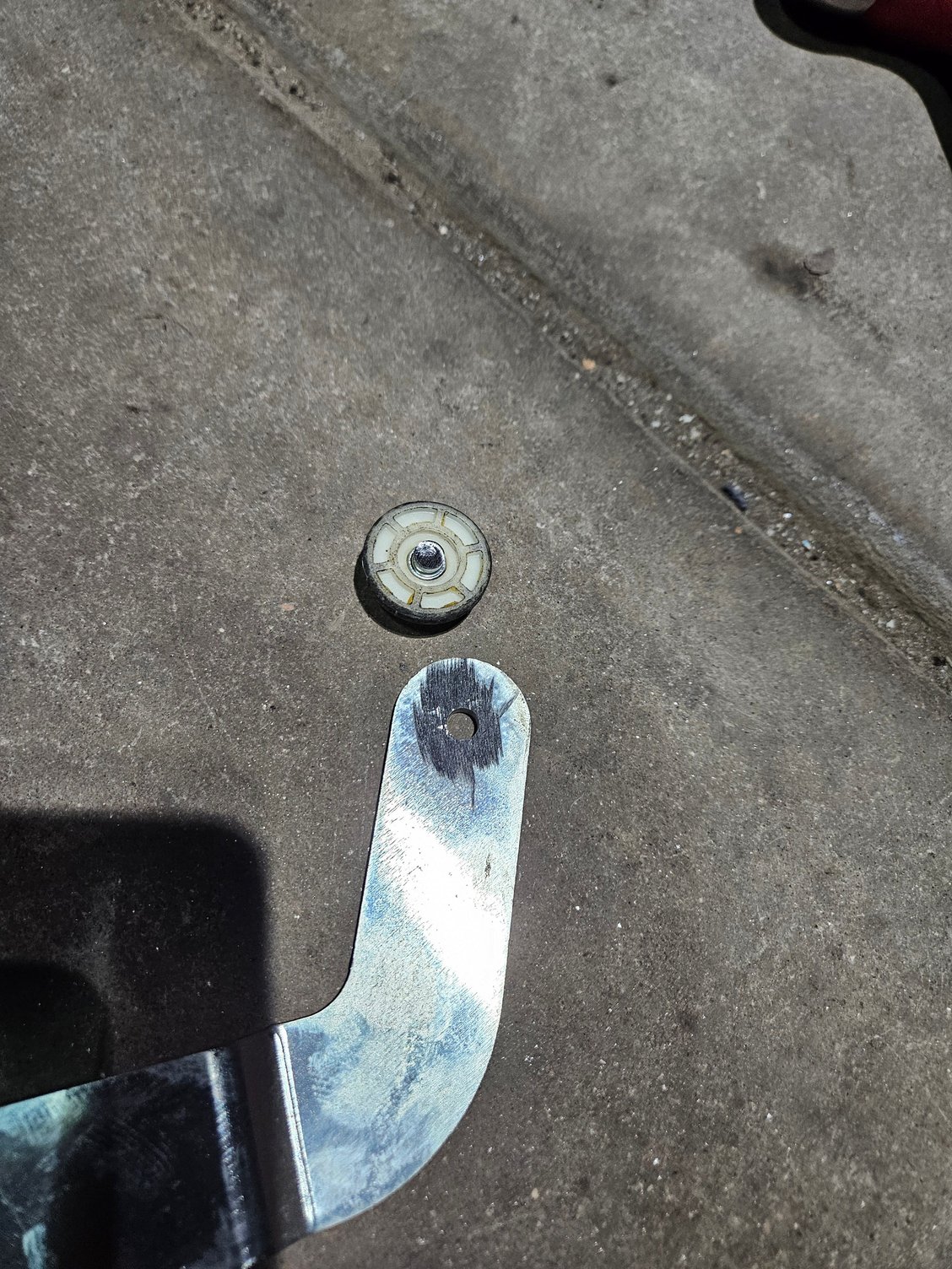

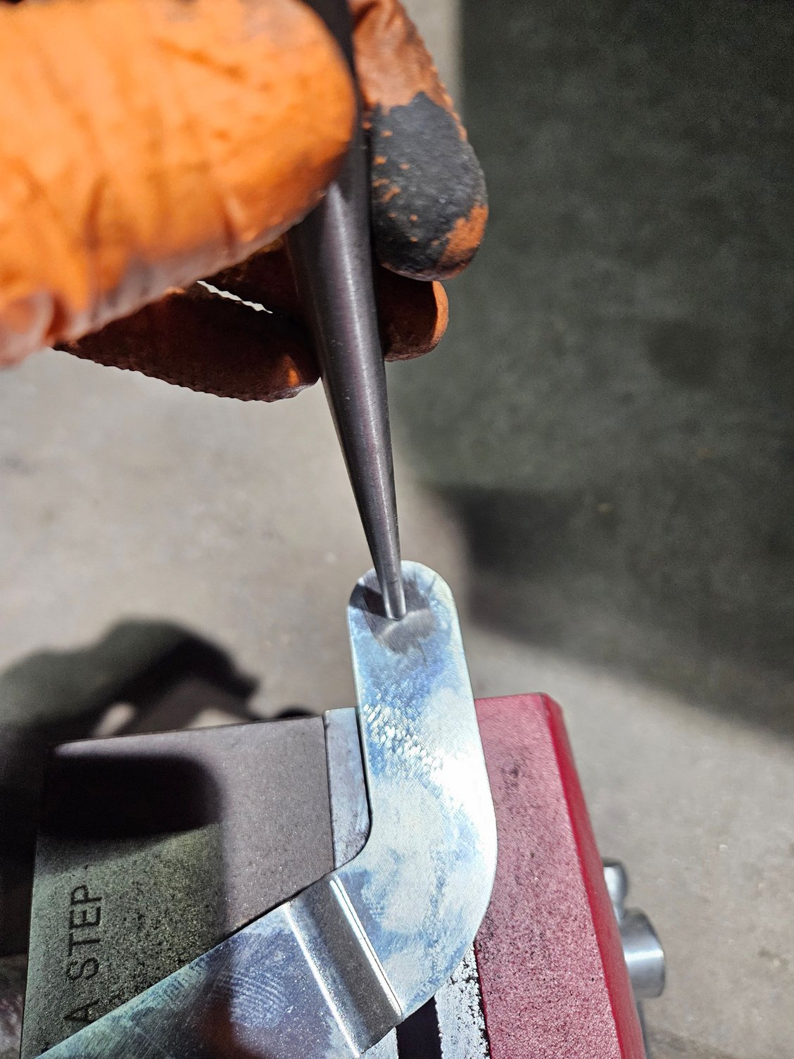

The top right side wheel broke off its center, sometimes they do this, other times they just disintegrate and break apart. Without the wheel to roll/slide in the track the arm can bind and this puts pressure on all the other arms, one or more of which will usually succumb to the torque put out by the motor and bend. In this example the idler, or maybe pivot, arm was the weak link. There is some minor deformation to the arm with the broken wheel but it's not evident in the pic. You can also see where the bent up arm was scraping against the other arm as the window was being used. You can sometimes get a few cycles out of them before your passenger comments that the window isn't working to their liking and catastrophic failure ensues.
The packet of wheels I received was slightly undersized and the factory wheels are actually slightly over 25mm. I'm not sure how accurate this HF caliper is so maybe the original wheels are actually 1".
In any event, the smaller wheels allowed the window track to **** a little when going up and down but apart from a small visual misalignment, there was no problem operationally. When the window got to the top or bottom it squared off per normal and as far as I'm concerned this is a non-issue. Knowing where this $13 packet of wheels came from I'm going to assume that manufacturing tolerance was not a priority. YMMV.
