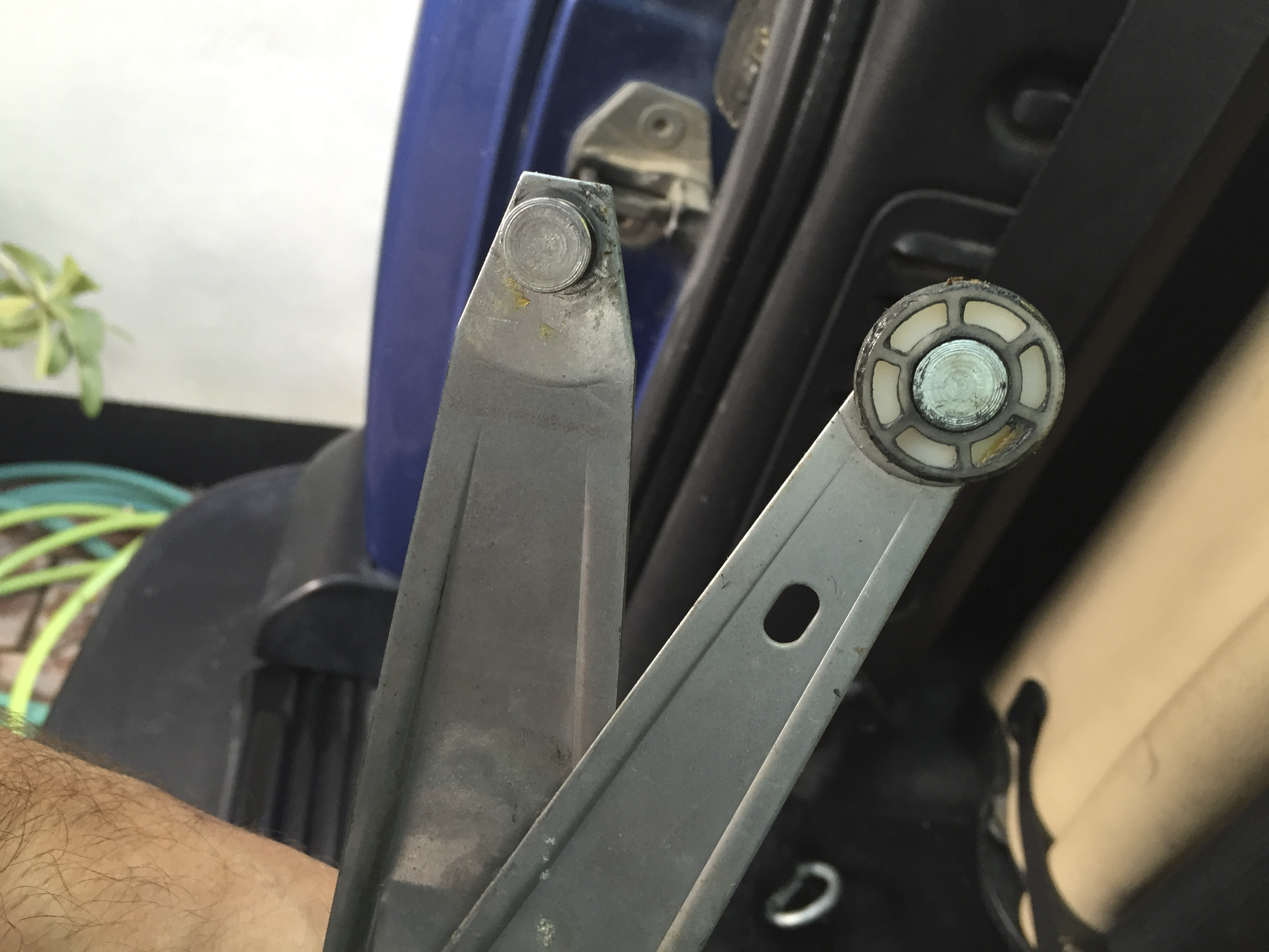

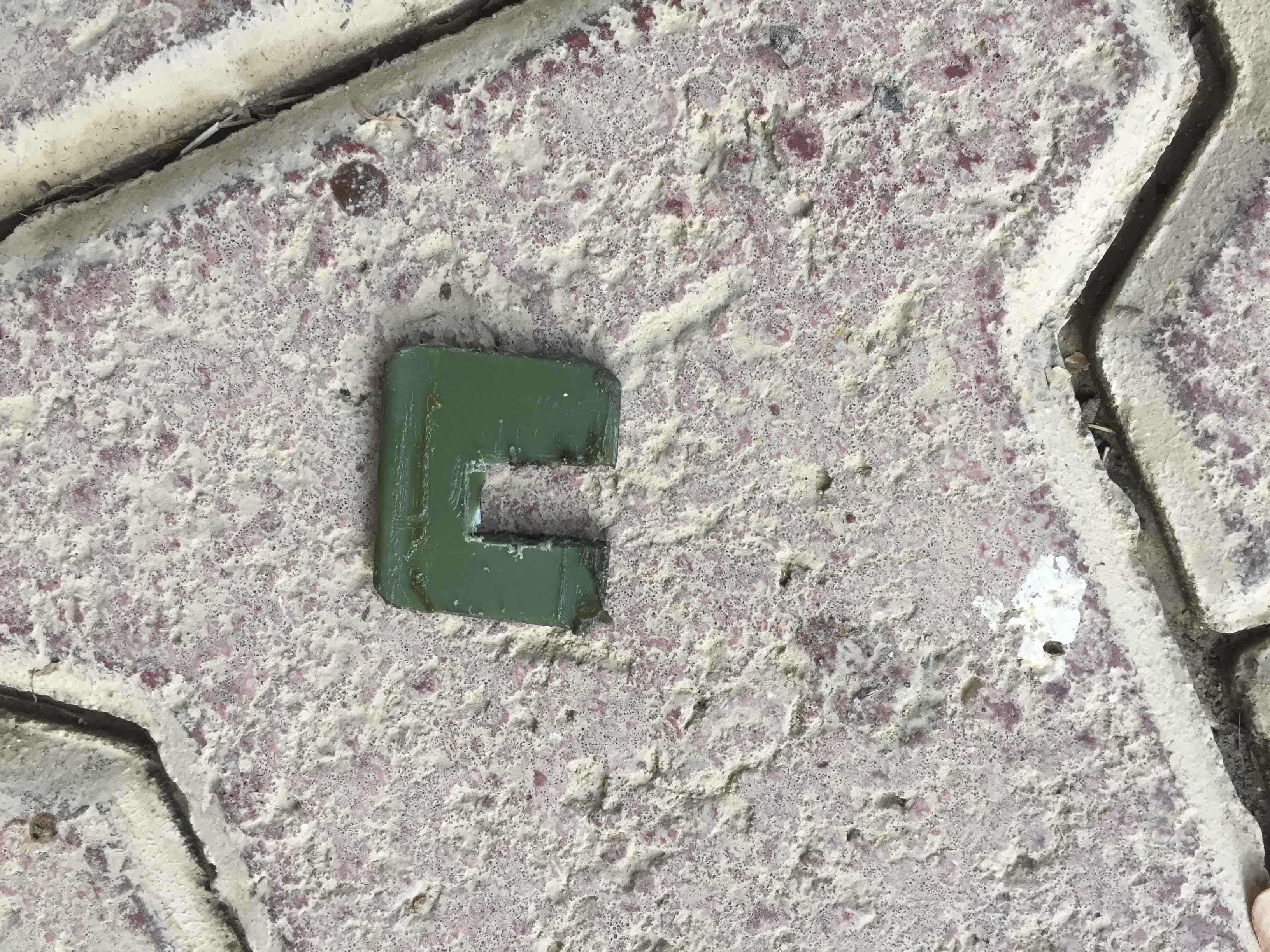

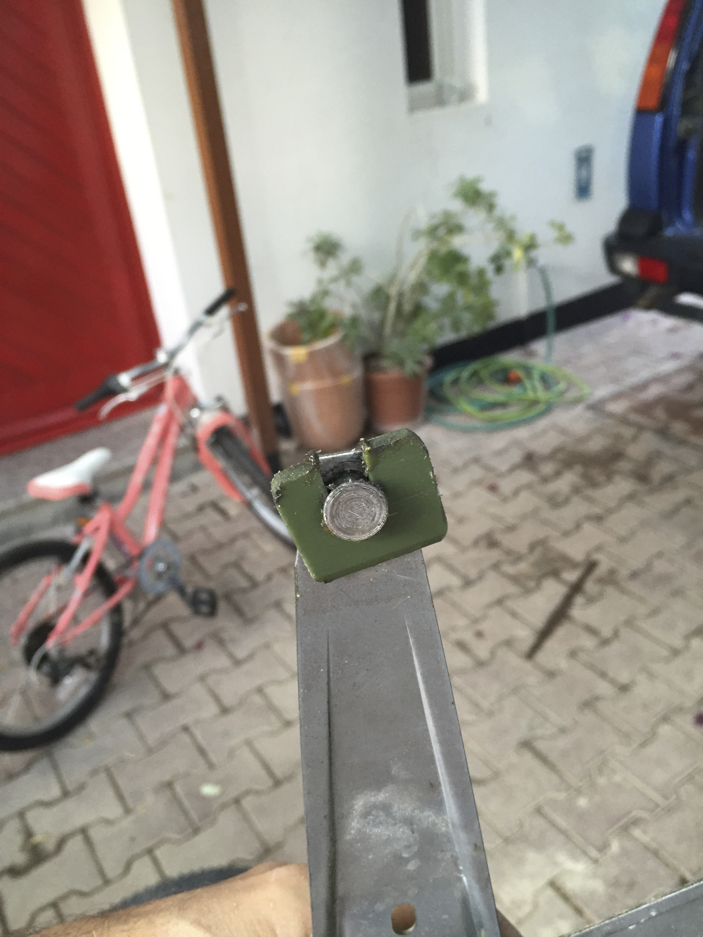

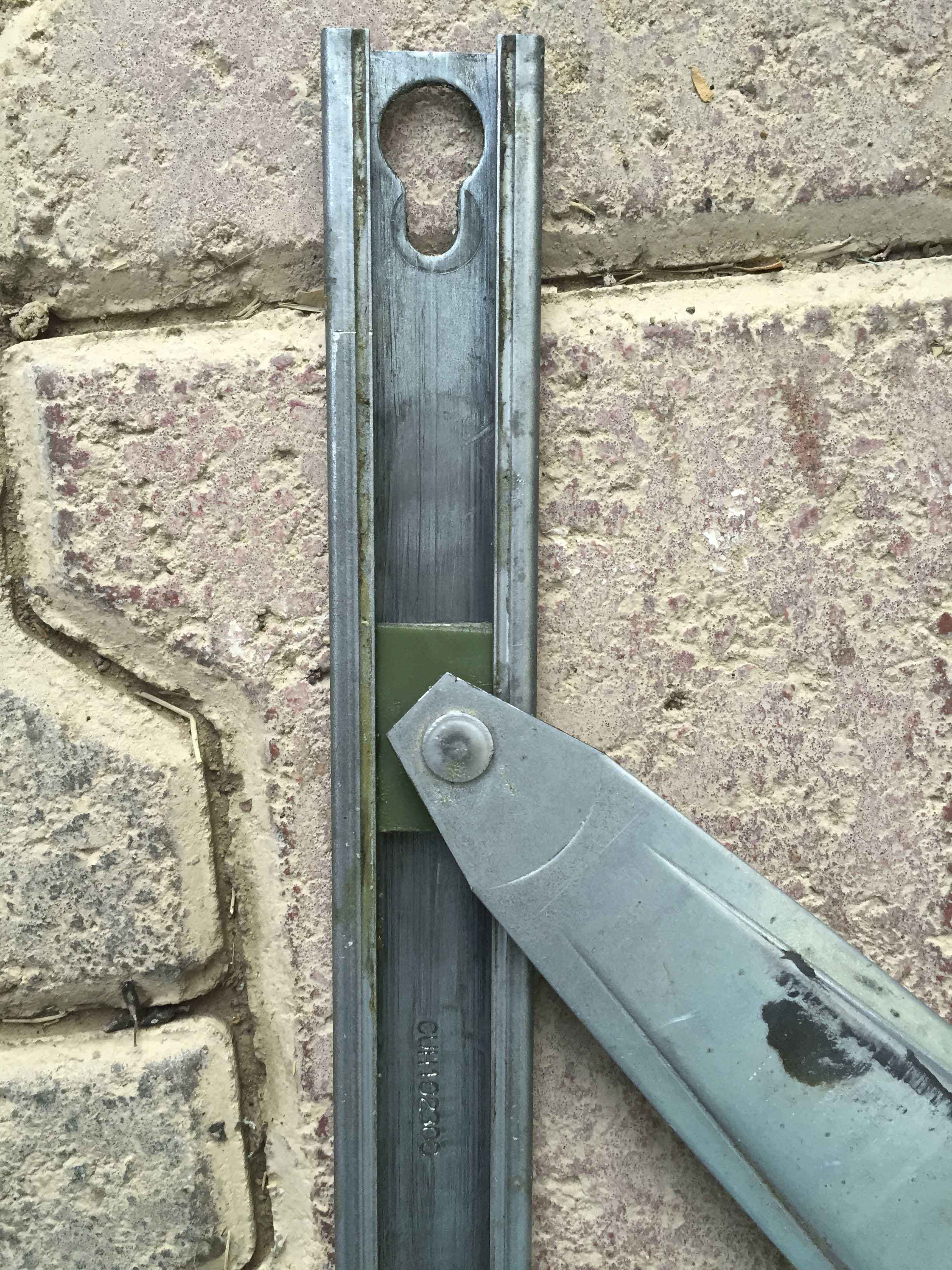

I have just fixed and replaced a broken window regulator nylon runner wheel with a piece of rectangular plastic. It was easy and straight forward to do. I thought I might share my solution to the community
Please take a look at the pictures I am attaching. Should be pretty much self explanatory, but I am happy to add information if needed.

So far so good But I have it only for two days now. I promise to give an update once it is stop working. I bet the other silly nylon wheel runners from Land Rover in the other windows will give up before this one goes...

Hi,
I just took a piece off of my driveway trash can It is thick, durable and strong.
