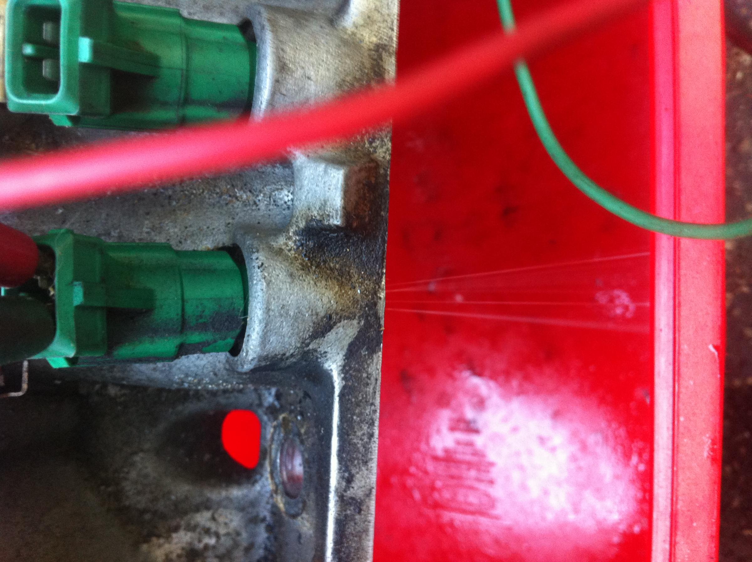

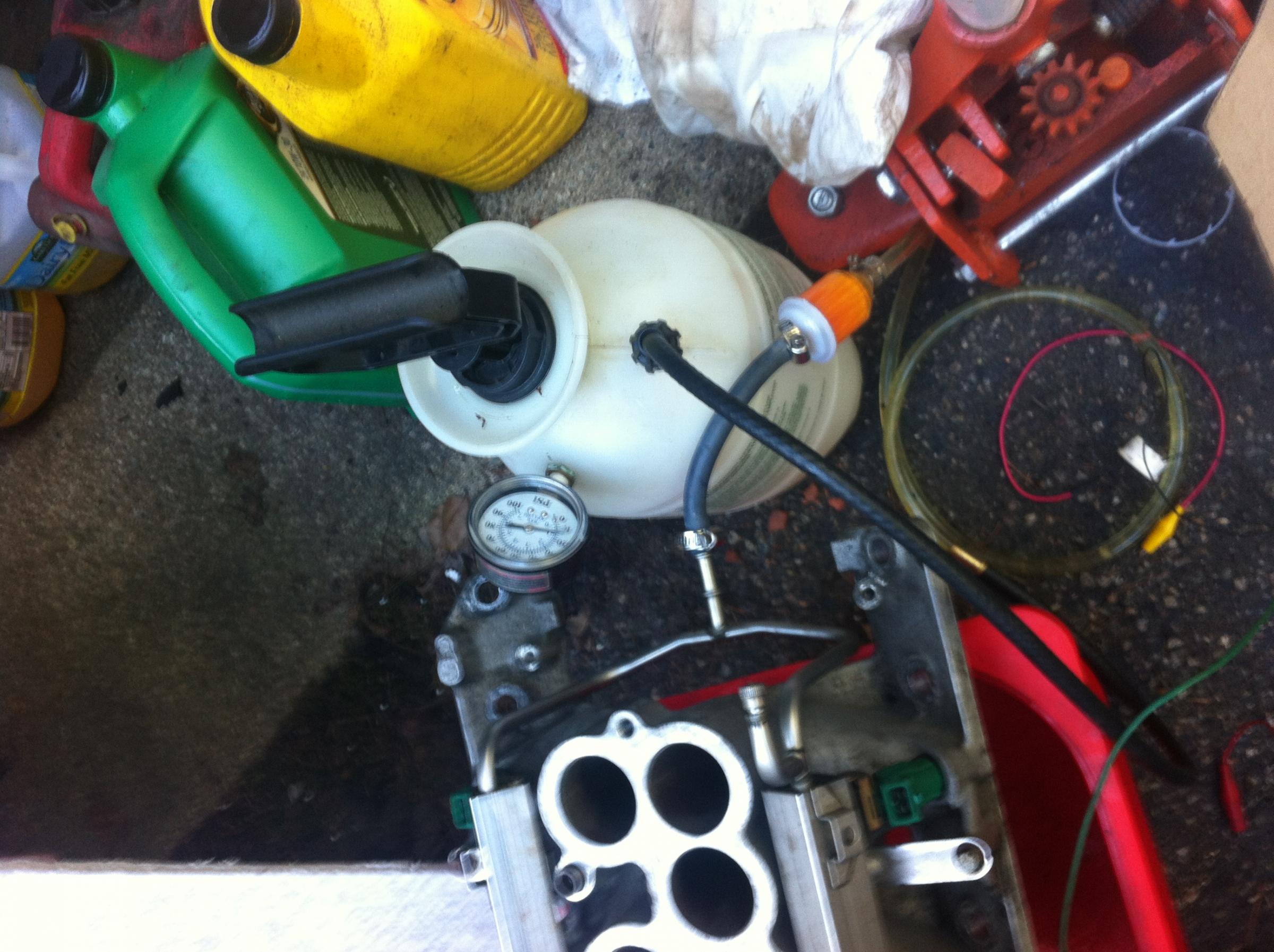

Originally Posted by Alex_M
That is correct about the lbs hr. The difference is actually supposed to be found in the spray pattern. The factory injector is a single hole injector where as the Ford injectors are a 4 hole design resulting in a more misty spray and therefore a better burn.
I just ran cleaner through mine and they are a 4 hole. You can see the 4 streams. I have to say, after seeing the inside on the manifold and heads on my truck the injectors are not the main thing holding it back from making more power. The inside of the casting is so confined and rough that it can't flow much air at all. Besides, I really don't see why people are so interested in trying out get more power out of these engines. Mine has plenty of power for such a heavy, boxy, ponderous truck.
