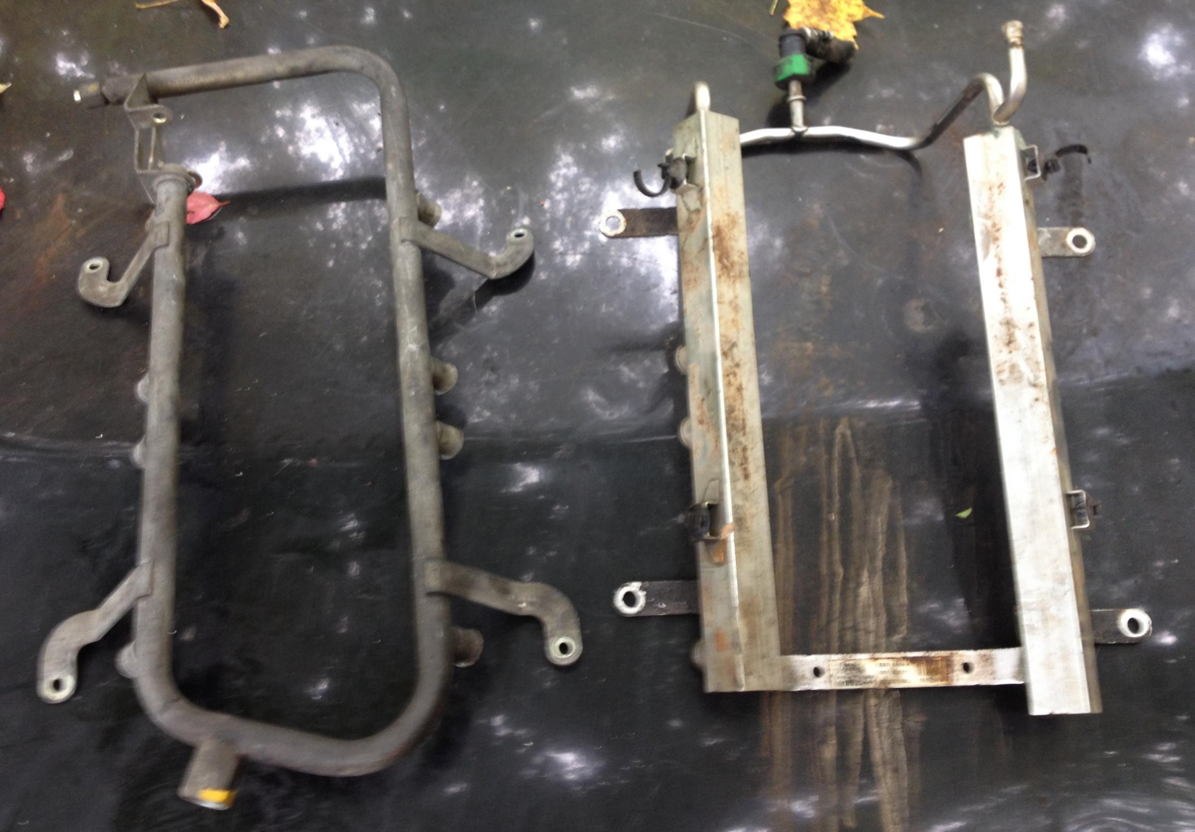

Just so you guys can see the differences between a DI and DII fuel rail. Granted, the DI fuel rail is, in reality from a Range Rover Classic but you can at least get the drift. On 14CUX DI's the only difference is the location of the port for the fuel temp sensor and that there is a schrader valve for testing fuel pressure. For GEMS DI's the location of the fuel regulator and where the fuel entered the rail was moved from the passenger side to the divers side rear.

Yea, looks like it would take a little work but it could be done. Thanks!
