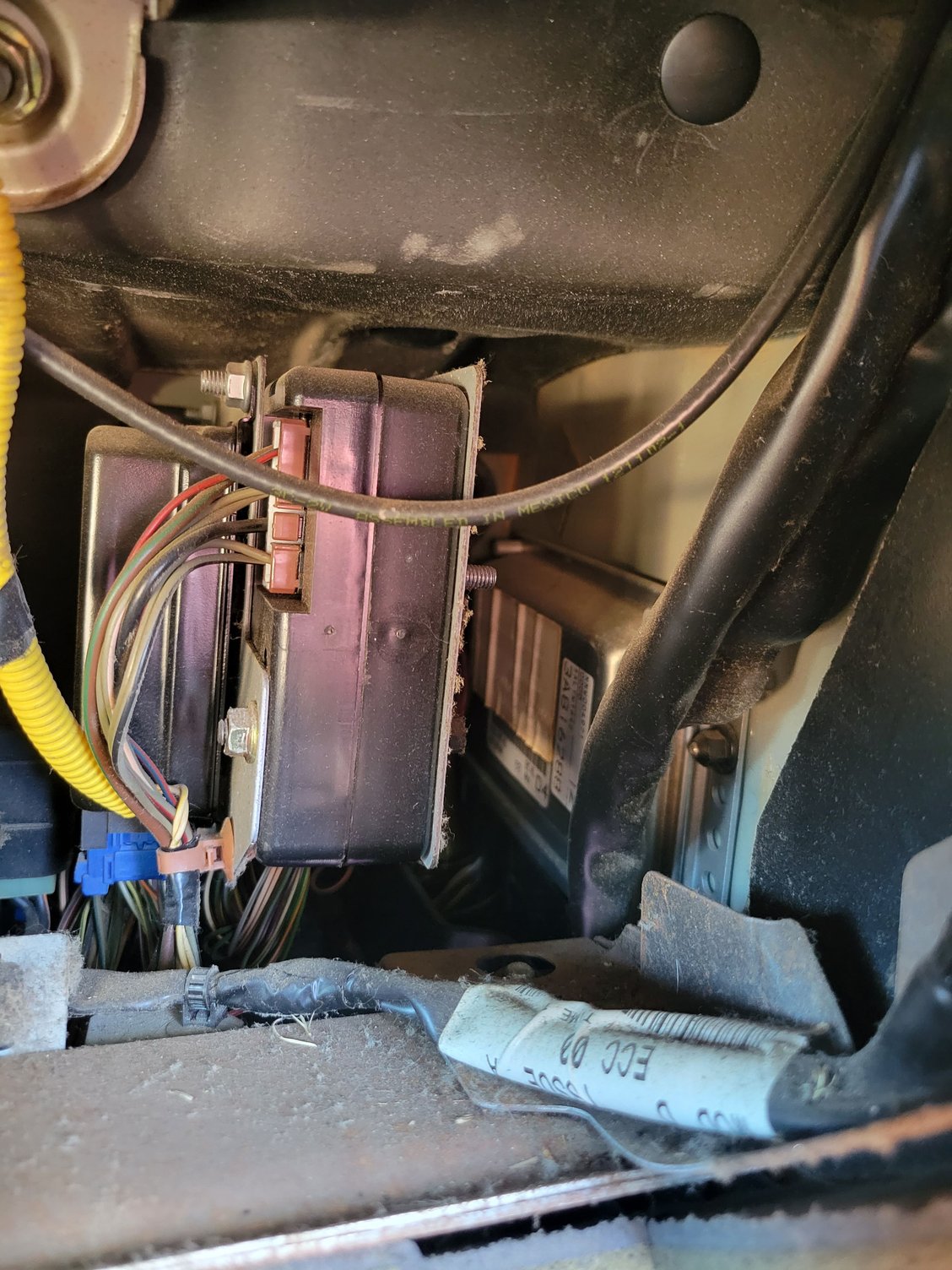

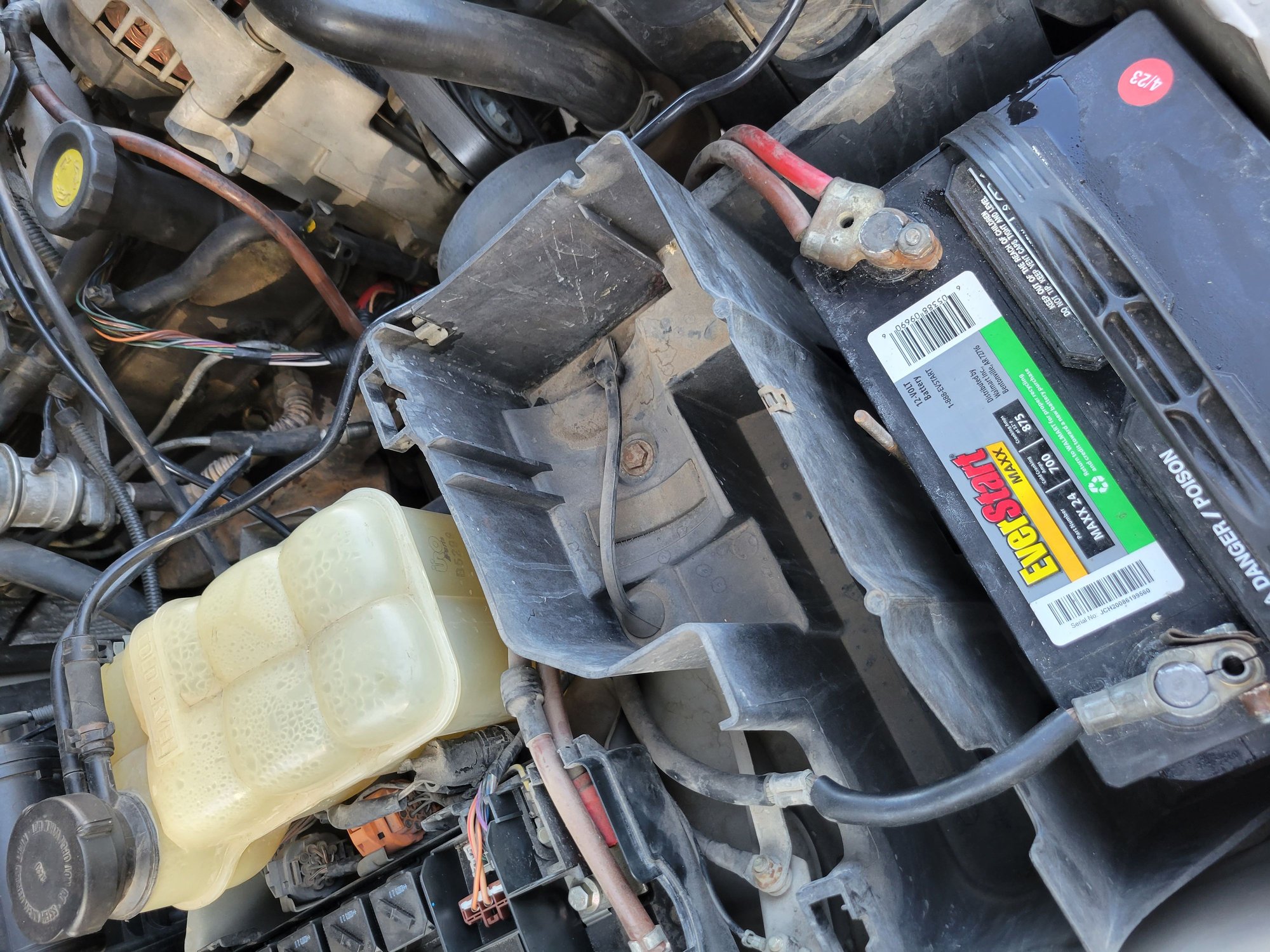

Hi, I'm working on a 2003 LR Discovery II and I'm having a no start issue. There is no fuel and no spark. I checked if pump worked, it does. I checked the relay and it's not receiving the signal to send power to the pump. Same thing at the ignition coil. Same thing at CPS. No power. Could this be an ECU issue? If so, where is it located? I've checked behind glovebox and next to the battery. Both behind the glove box and next the the battery are voids where the ECU could fit. Where else could it be?

​​​​​​The ECU is under a cover below the glove compartment.
