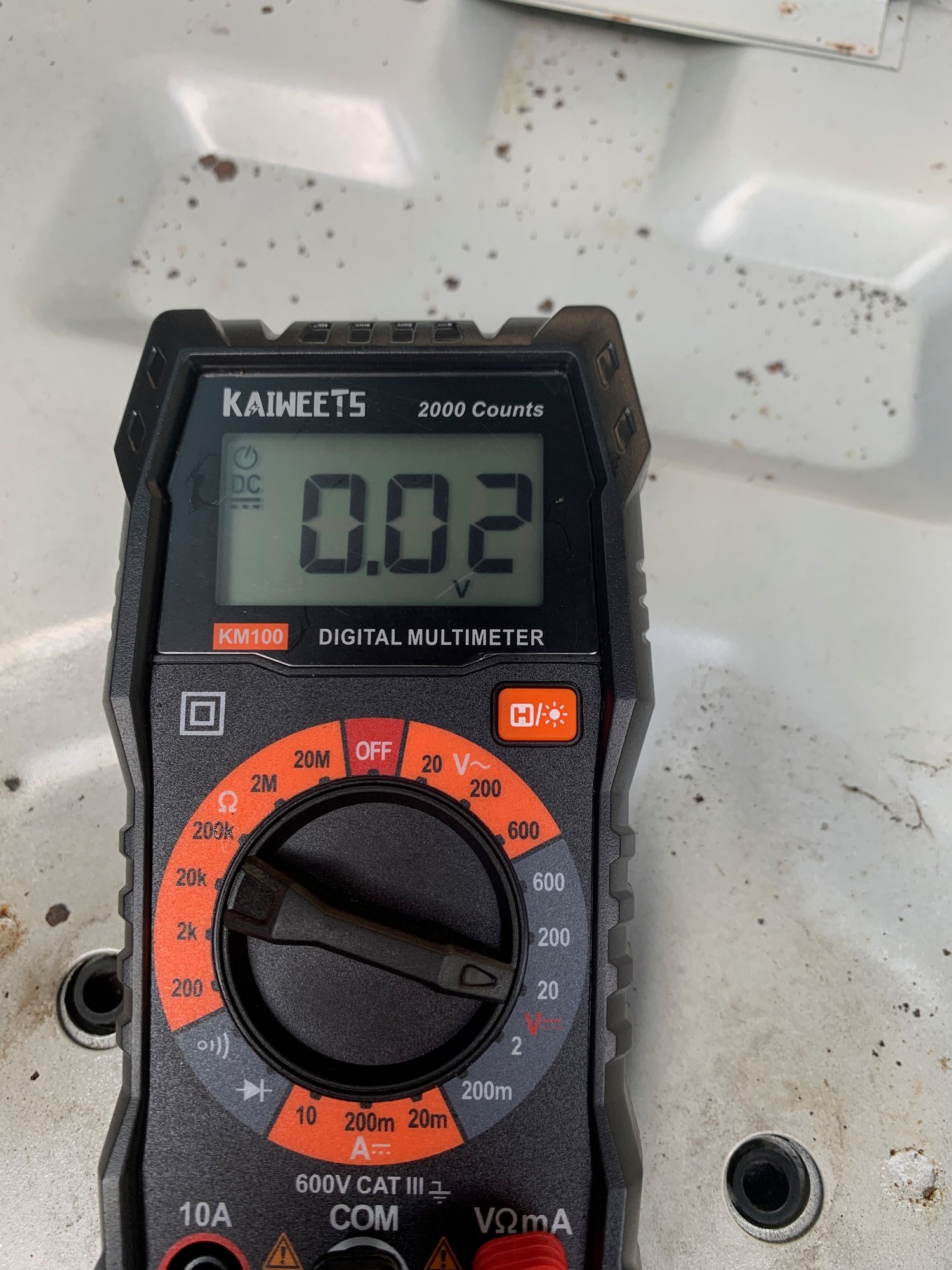

Hey everyone, just bought a 2003 disco II. It has no power to the fuel pump and only 6.7 volts at the relay - not sure where to go from here. Please don't tell me it has anything to do with the bad brake pedal switch. I'm replacing it. I have swapped relays, checked all fuses, and bypassed the inertia switch - in need of help.
At the fuel pump
Thanks for your help in advance.

After resetting the fuel cut-off - it was weird I did not have to press it very much - I now have 11.9 volts at the pump when cranking. Guess I need a fuel pump.
