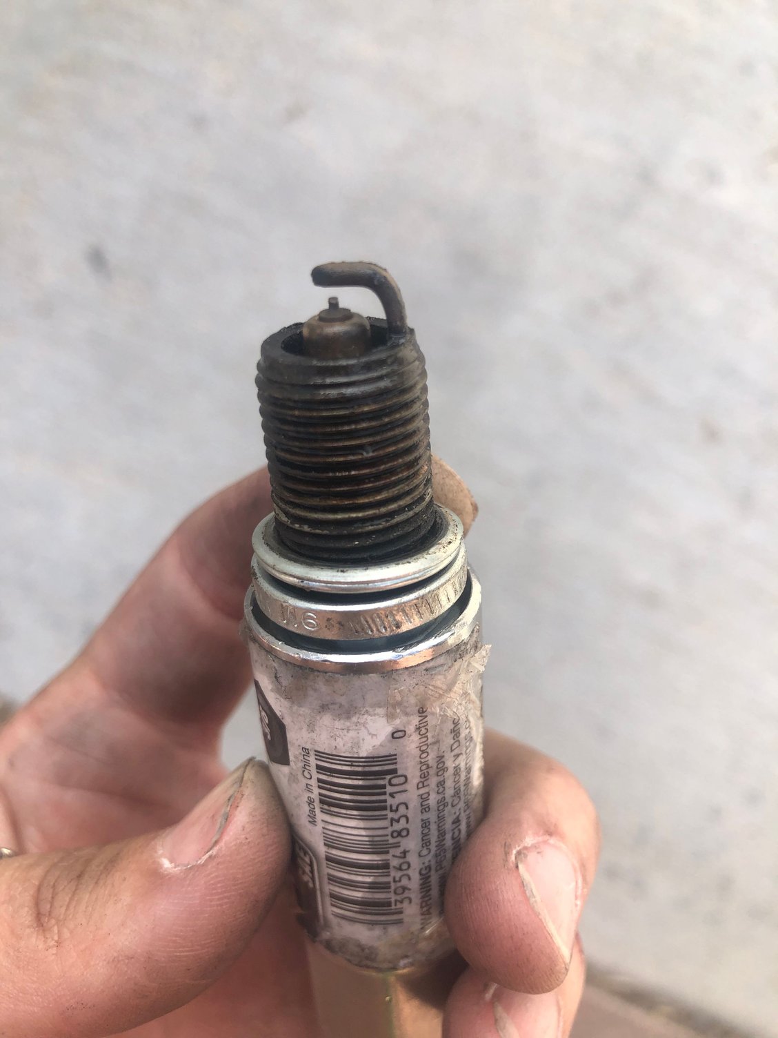

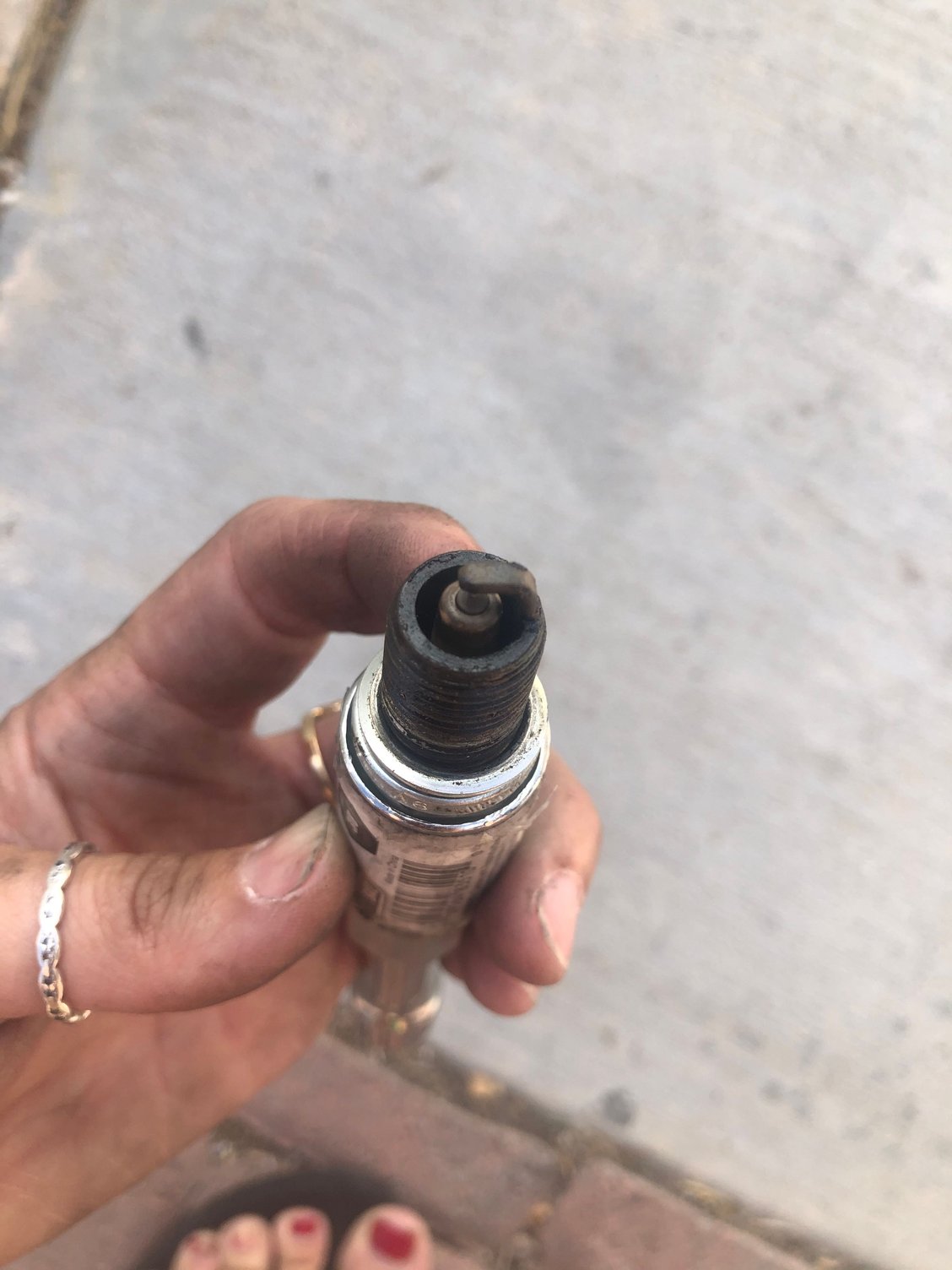

thank you! The part came in the mail yesterday and that code disappeared this AM when I installed it. I pulled the plug on cylinder 4. It has around 2k miles on it. Pics attached

That's how my plug looked when I had coolant leaking into the cylinder from behind the liner. Caused a lot of misfires. I could clean the plug and drive for 20 or so miles and the misfires would start again.
If you can remove the plug when the engine is still hot and that black crud is damp that is a clue. You can also inspect with a cheap USB boroscope by looking into the spark plug hole for signs of bubbles around the seam between the block and the head. You also have to do that while the block is warm and coolant is still under pressure.

Try pulling a couple of others to compare ideally from the other side
