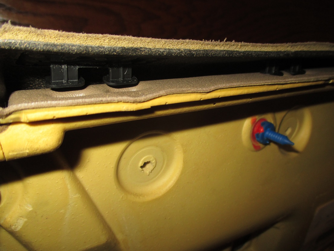

So there have been discussions, but no solutions on fixing the alcantara panels on our door cards. The alcantara is actually applied to a hard plastic panel that is actually removable with a little creativity. The driver’s door panel is the one that I will cover in this write up. So the alcantara panel is anchored to the door by 5 clips that anchor into wells on the door panel.

The first thing to do is remove the wood trim, and the leather handle pull on the door. The handle is held on by two goldish colored Philips screws with washers that are on the back of the door card. The wood trip piece is held on by five plastic cap nuts, although I do not remember the size. Once the wood and leather pull handle are removed, the real fun starts. Using a long thin flat head screwdriver, pop the 5 clips out of their little wells that are in the door card. There is a trick to doing this, the clips have 2 anchors on each clip, you have to pry up in between the two anchors, or you will break the clip. I found it best to take a narrow flat head screwdriver and slide the head flat between the two posts on each anchor then rotate the screwdriver back and forth to get even light prying on the two posts. Once you have the 5 out step one is done.
