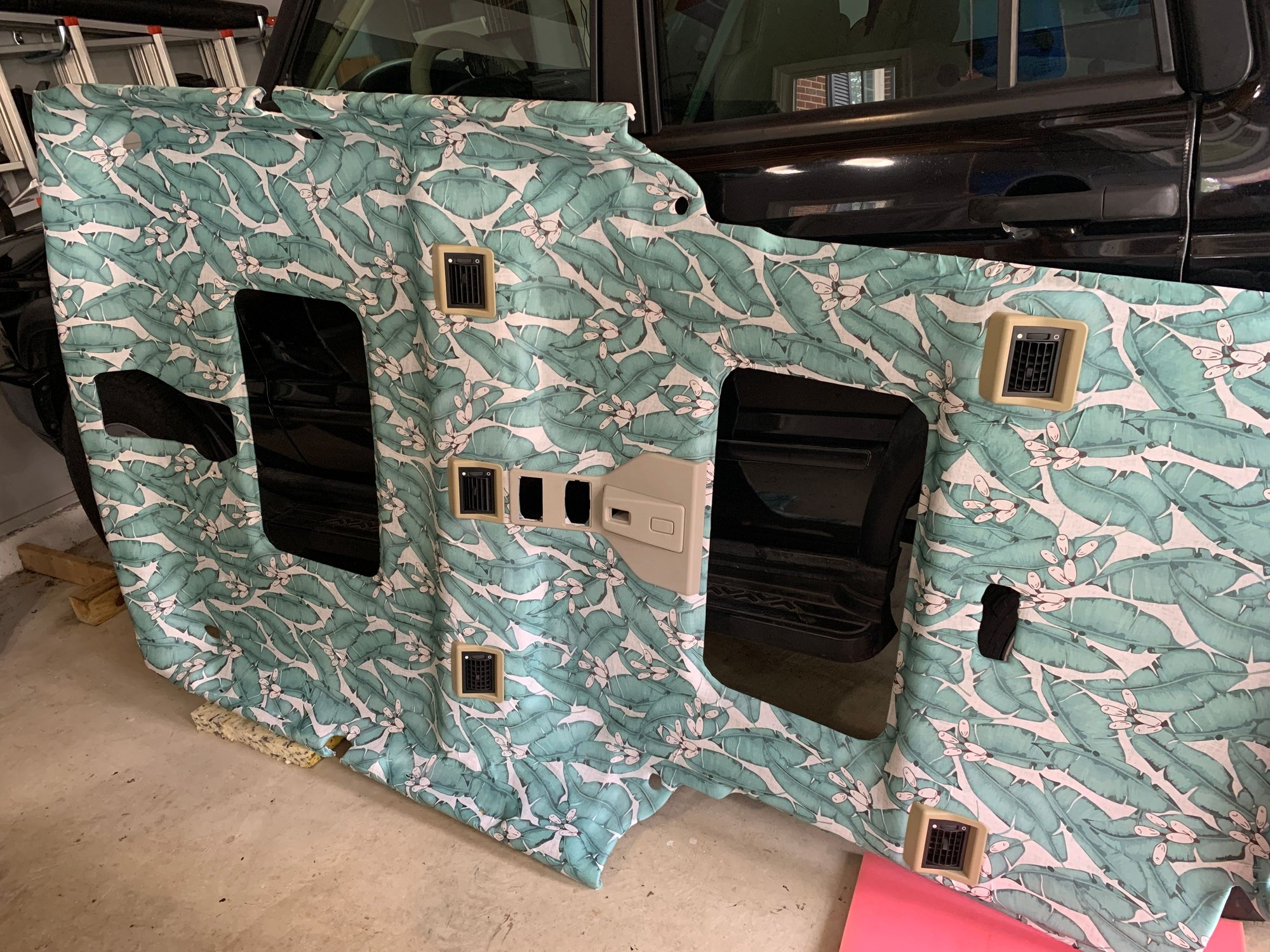

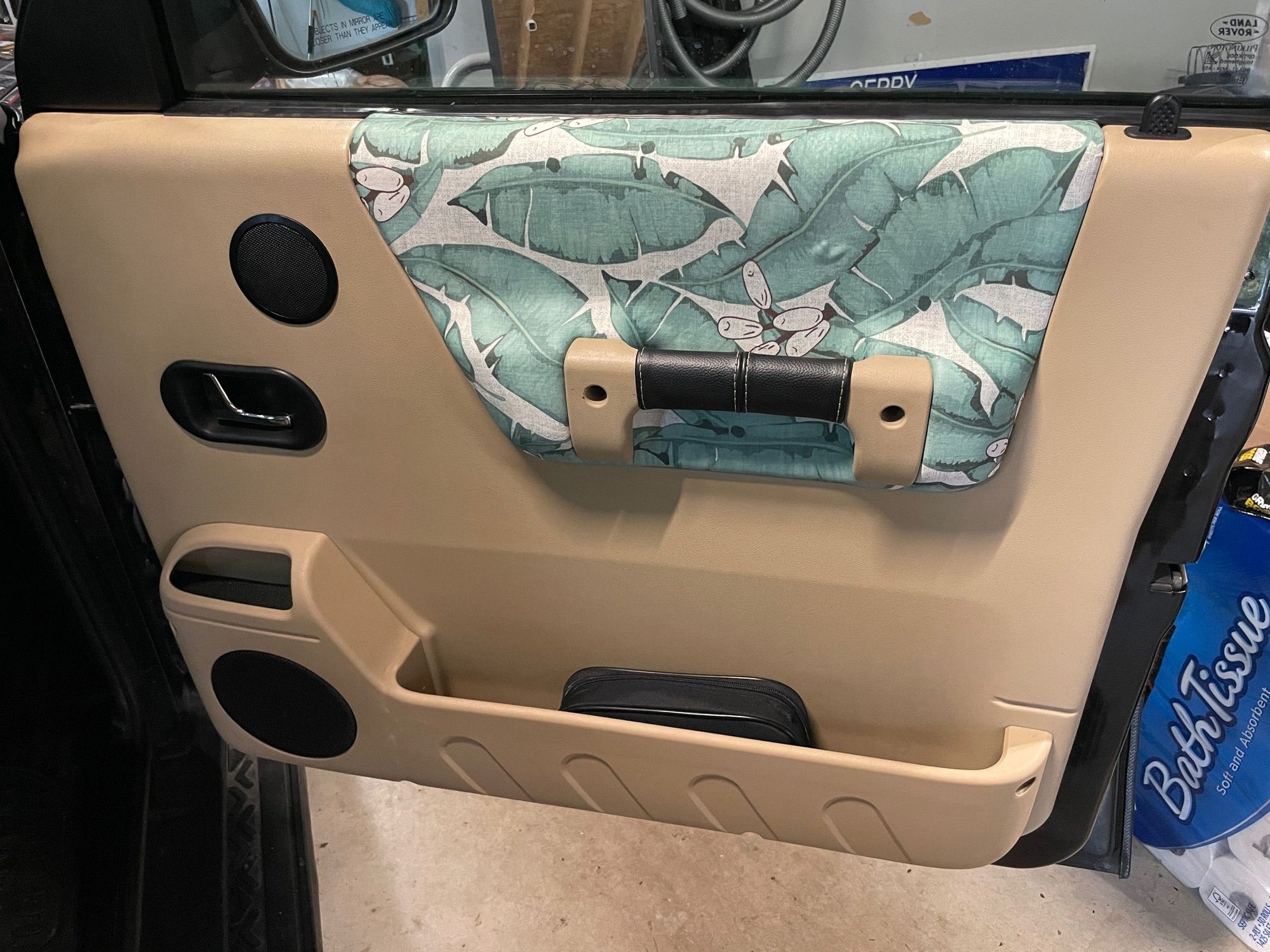

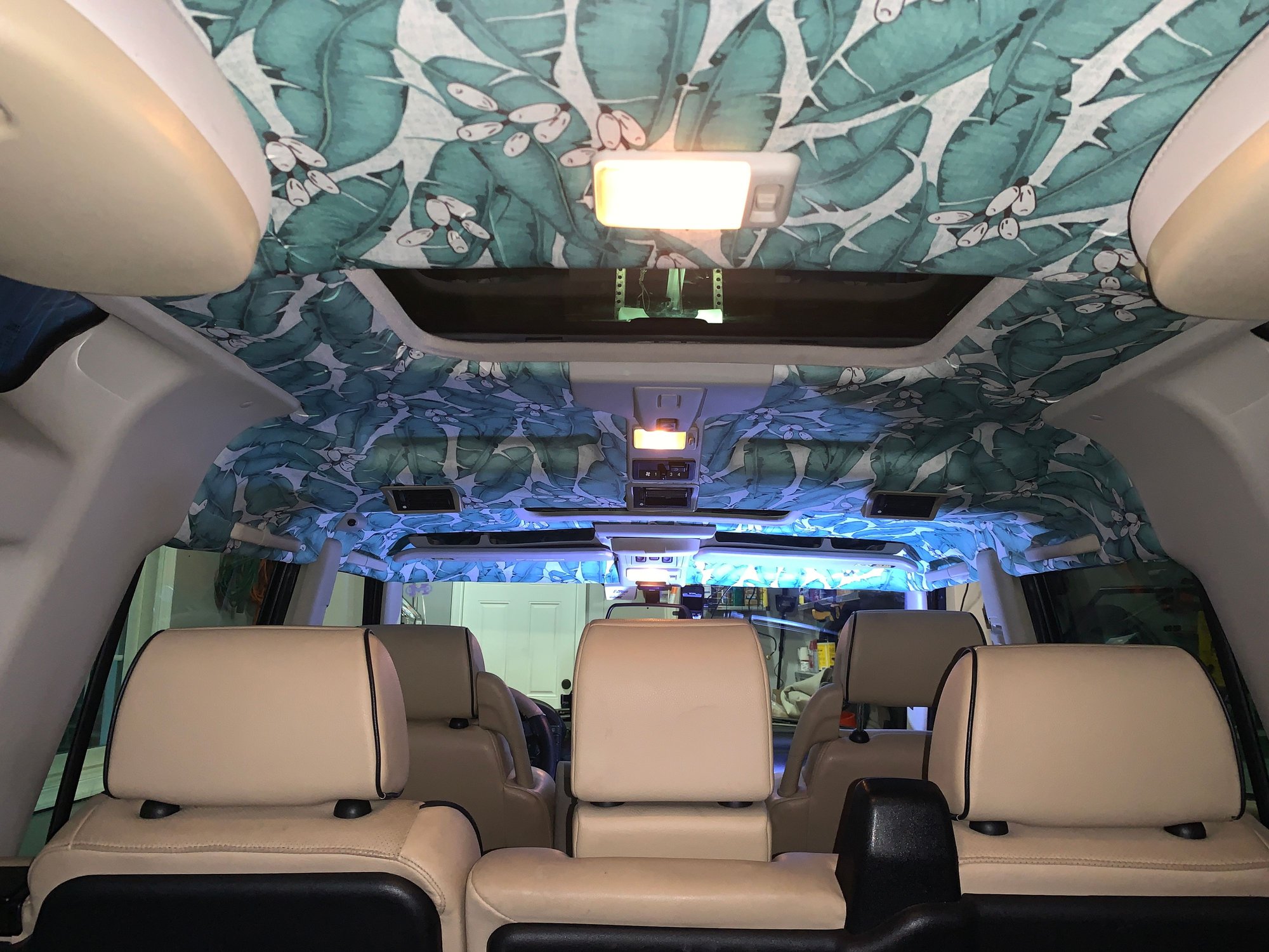

A big thank you to emncfi for this write-up. It gave me everything I needed to tackle this job myself.
A few years back I redid the ceiling using some stretchy fabric I picked up while visiting Kauai. Yesterday morning I found the left over fabric and a near full can of 3M headliner spray glue, and I thought matching door inserts would look nice, so, after about 8 hours of work, I'm very happy with the results. Since I had the doors apart, I also added lots of sound-deading mats to the interior door panels and greased the window regulators before reinstalling the door cards. I left the original Alacantara in place because the new material is thin and the Alacantara acts like a padding underneath.
Results:
The ceiling I did a few years back:
