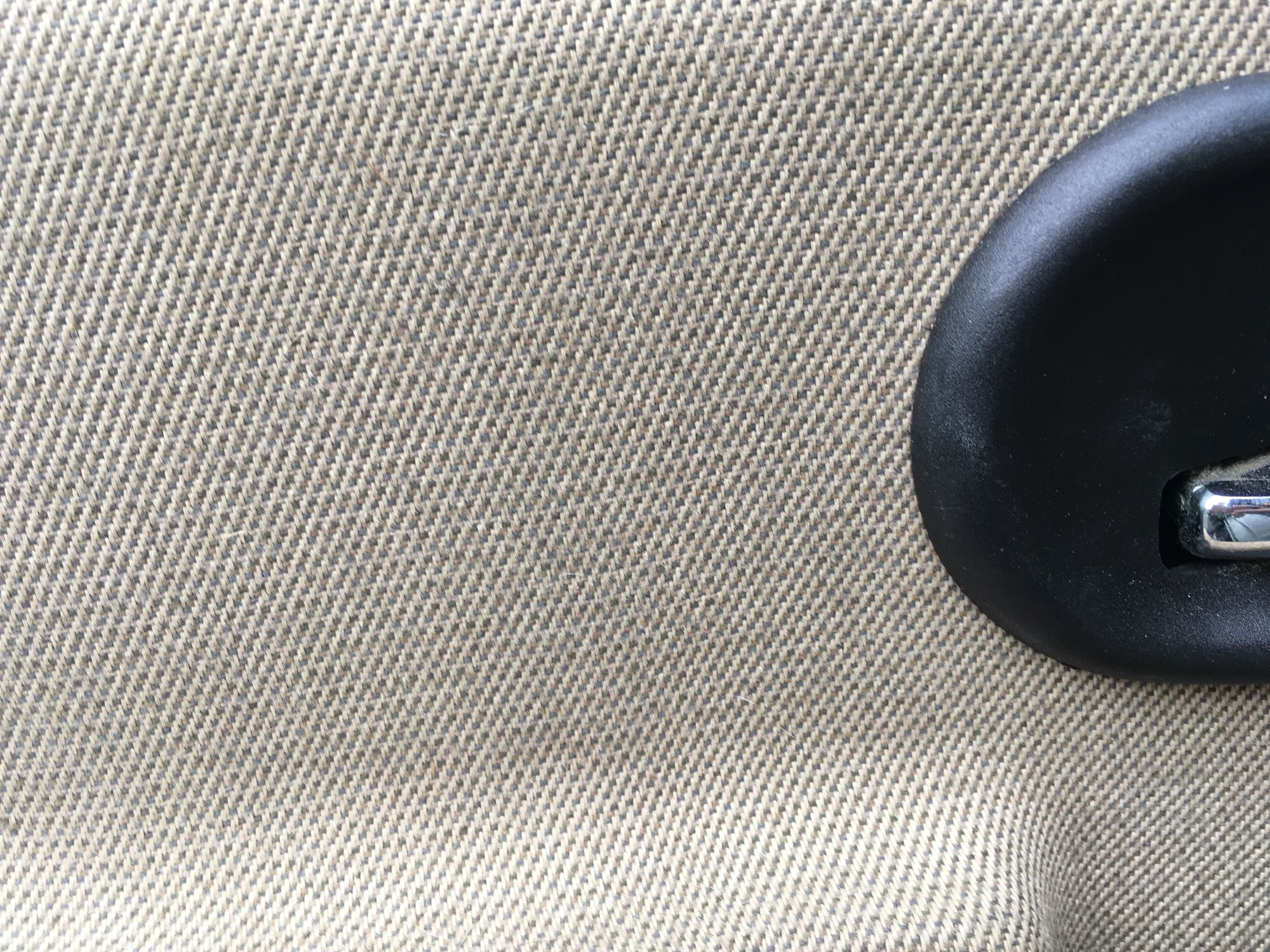

Great into! Does anyone have a link to where one would buy the fabric that matches the 2003 alpaca beige interior? And also, I have an S model the material does not look like the suede I see in some pics, more of a houndstooth or tweed look. Did they use a different material in the base model?
Edit to add pic...

To answer my own post, It appears that the S models do not have Alcantera inserts in the door cards. Turns out using a cleaner and water on the material took away years of dirt build up on the fabric on the drivers door insert. It must be something synthetic as it looks brand new again.
