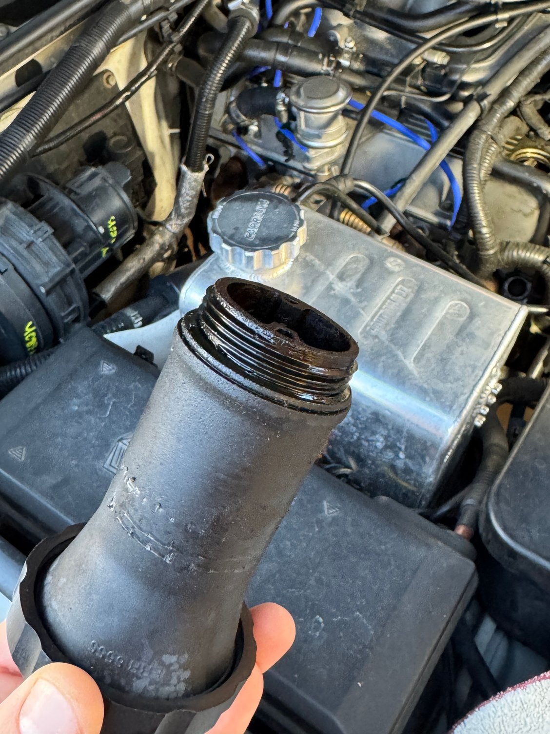

Real simple DIY today. If you're on the hunt for vacuum leaks, one that often gets overlooked is the o-ring that sits between the rocker cover and the oil filler spout.

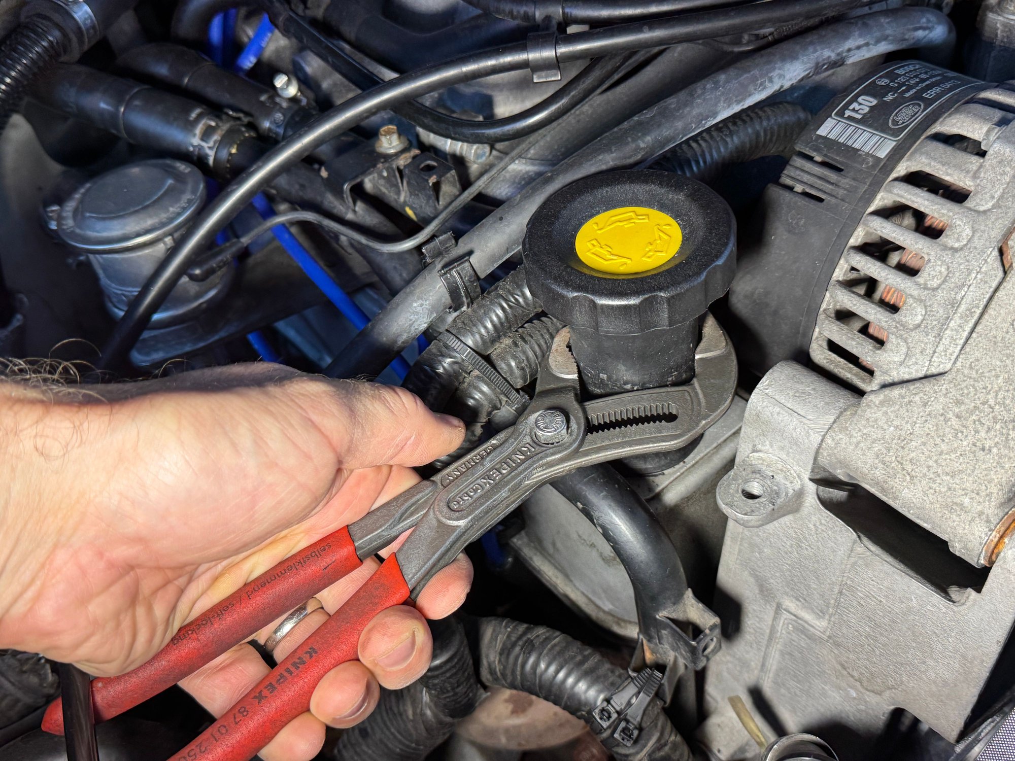

Replacing this is dead simple. Just remove the oil filler spout with some kind of pliers. Make sure you're orienting them the right direction or the teeth will skip over the oily surface.

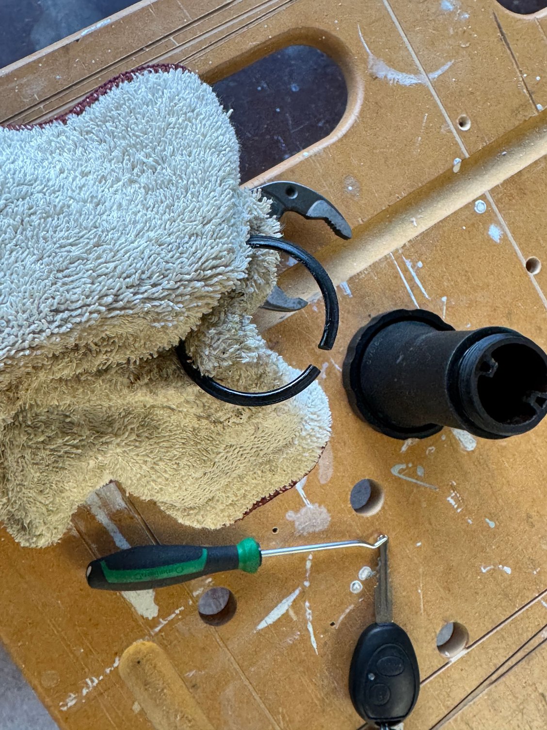

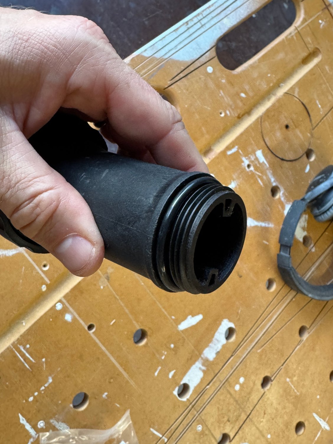

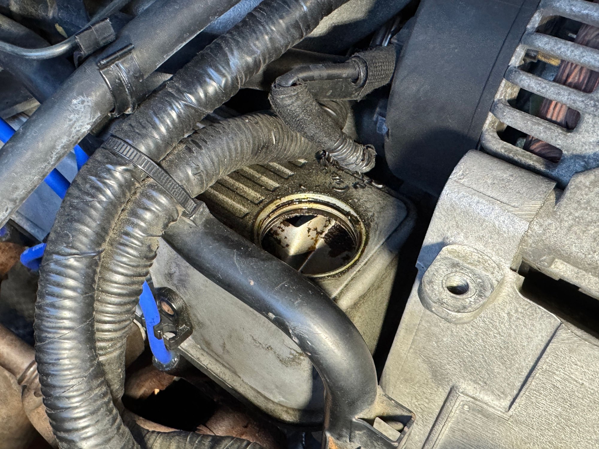

Once removed give the area a clean. Remove the old o-ring and replace. My OG o-ring was the consistency of super hard plastic and even cracked when I removed it. The new one is super supple rubber, as one would expect.
Installation is just reverse of removal. I just snugged it up, don't over tighten.

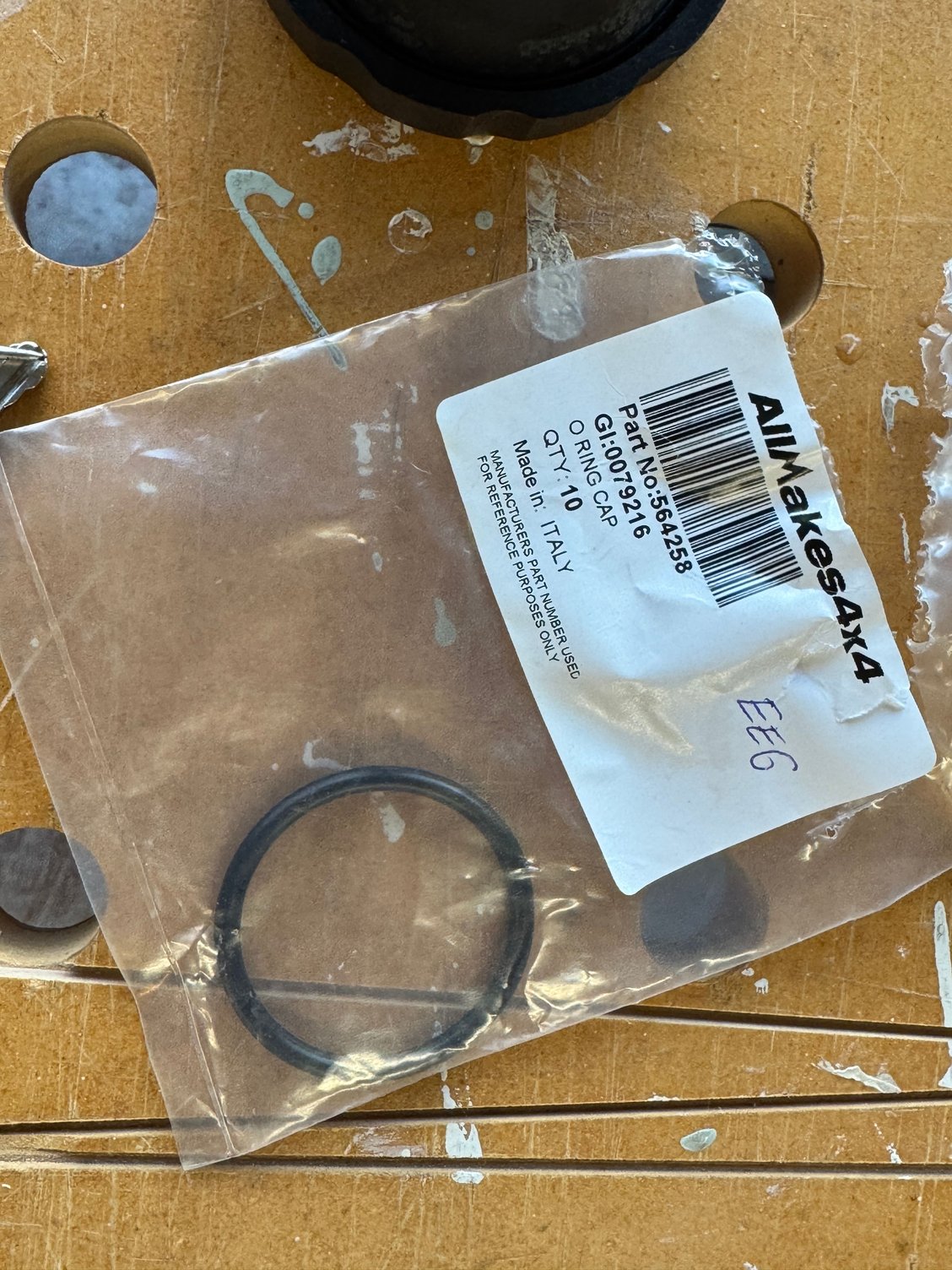

Part number for the new o-ring is 564258.
