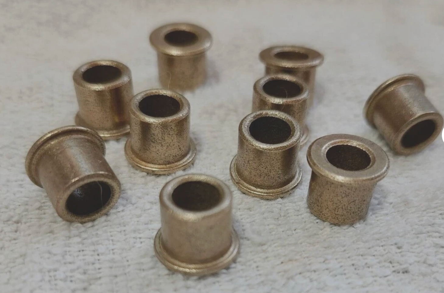

here is what I'm thinking of doing instead of getting a welder involved...
drilling the hole in the bracket out (which is already out of shape) to 3/8". take one of these and cut it down to a length of 3mm which is what each side of the bracket is.
then press it in from the top using loctite red to keep it in place. that should bring it back to a 1/4" hole again.

It probably doesn't make a big difference, but the green loctite 609 is made for holding bushings in their holes.
