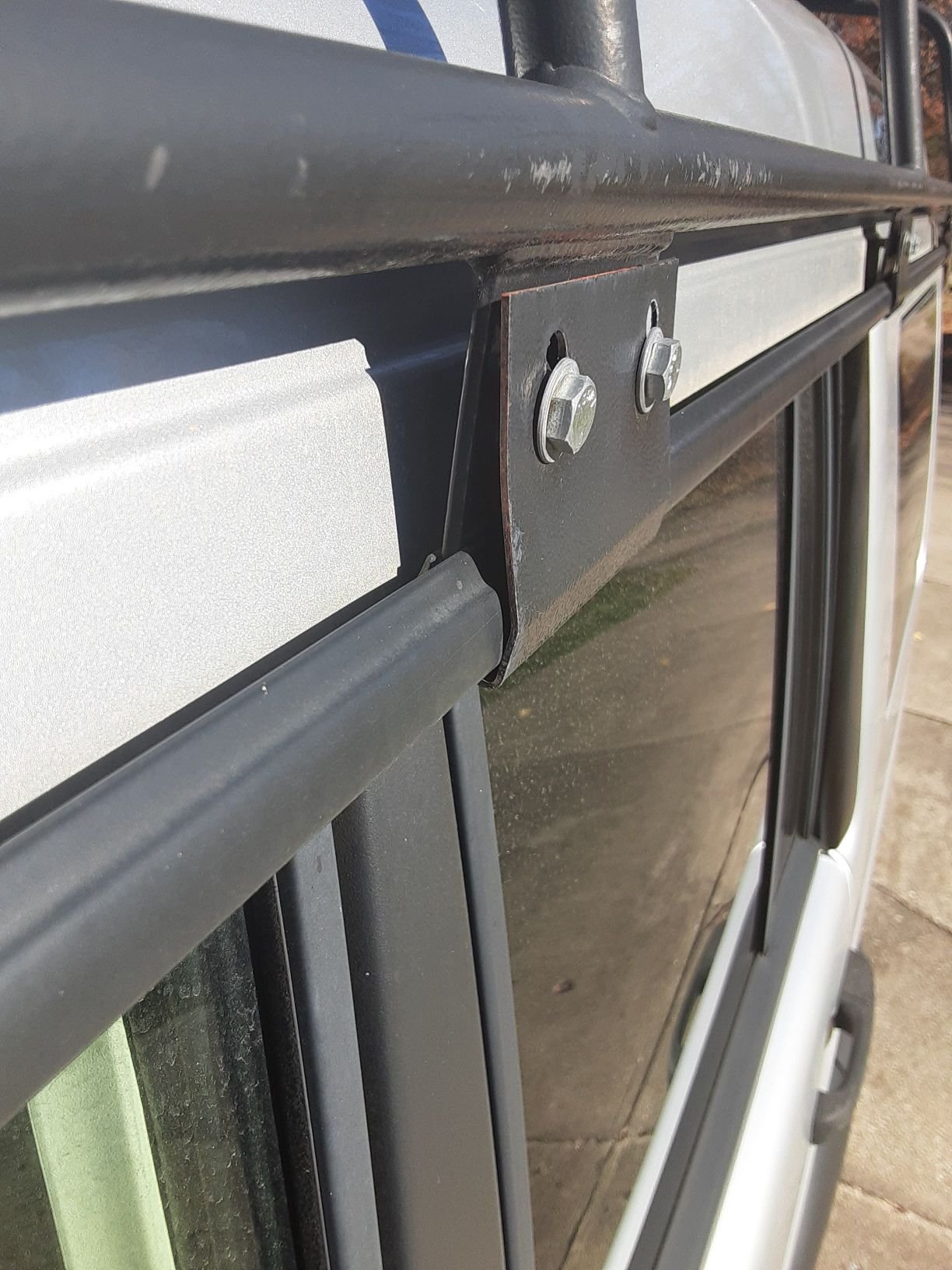

there are hundreds of styles of universal/generic types of rubber trim for auto and other uses:
https://www.grainger.com/category/ha...dge-trim-seals
but they look like rubber trim, not the original. Here is one that is somewhat similar:
https://www.grainger.com/product/TRI...f-Liner-48RL38
I'm sure there is another one out there that is even closer...with a U channel and peel n stick...
I used the pure rubber U channel (without the internal metal clamps which tend to rust quickly) to protect the inside sill from the rack. You can just see part of one in this pic.....

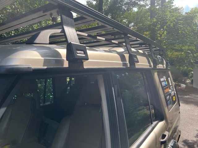

Interestingly enough, I found the same product on my own after searching for an hour or so on Amazon:
Amazon Amazon
I think it's better than factory, I've had a Voyager rack and a Front Runner rack on my Disco, which are what destroyed the gutter trim. I used that material and cut it around the feet of the rack so they can clamp on metal, which looks better anyhow because the feet are flush with the trim. It looks just like factory otherwise. The trim comes with 3M tape and sticks very well.
