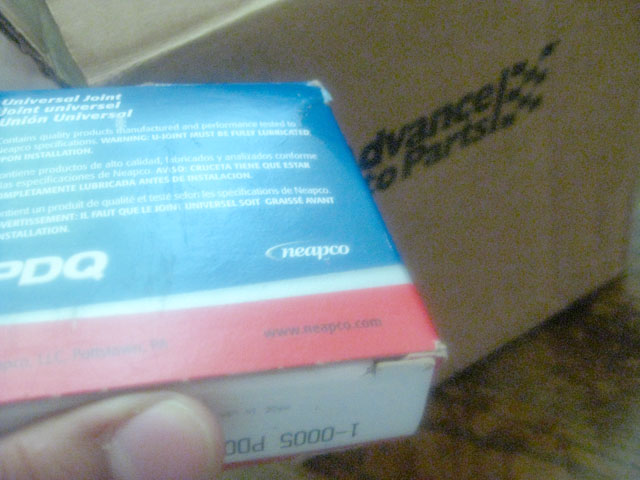

Oops - that was a typo on my post. I didn't order them from Autozone specifically for that same reason. I got them from Advance Auto and got some Neapco PDQ-boxed good ol' USA-made u-joints. See my post here:
https://landroverforums.com/forum/sh...ad.php?t=30590
or pic below.
Thanks for noting that.

I tried to go to Advance, but they didn't carry the u-joints and had no way of knowing when they could get them in. Autozone isn't ideal, but they at least had the joints...
I was able to get the centering ball kit from Advance, well, it'll be here tomorrow. Should I take the ones from Autozone back and find something else online?

Got home last night and looked at the ones I picked up from Autozone and can verify they're the same PDQ branded ones above, right down to the neapco logo on the back.
I think some Autozone stores have NOS, so you lucked out. For a while I could still find them at autozone, but slowly all of the Autozones around here have gone 100% Duralast (the chinese ones).
