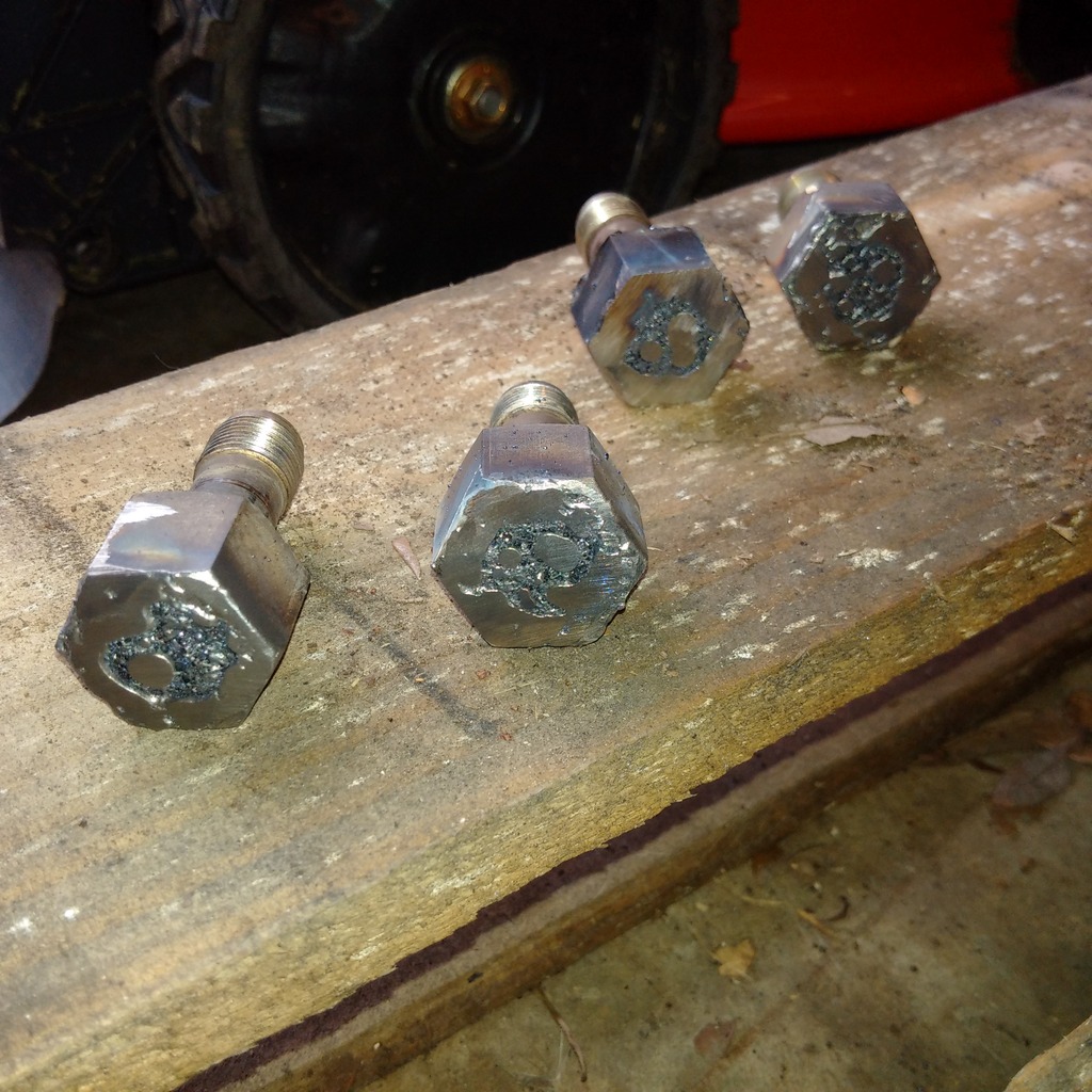

Ah. Well at least you got them off. I pulled mine from the spare engine and welded them (the open compression nuts) shut, then removed all of the SAI stuff... but I have non SAI computers.

My welding skills are limited to burning a hole where I don't want one, and using so much rod that I have globs of if... so it fit my skillset.
