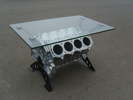

If no core deposit would make a great man cave item.
