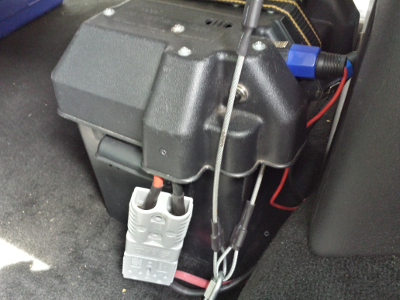

I use an isolator called "Battery Doctor" and a second battery in the trunk in a battery box. AWG-4 wiring goes along the right side frame and through the body behind the tail light. The isolator connects both batteries when the alternator voltage is high enough, otherwise they are always isolated from each other. I can take the second battery easily out (150A Anderson connector) for charging at home or use it as power source for charging phones and stuff in the tent.

Found some pictures:
Battery in the trunk.
Connection at the starter battery.
Battery isolator in the jack cubby.
Holes for wires behind the tail light (one is for an external 12V outlet under the rear bumper)
