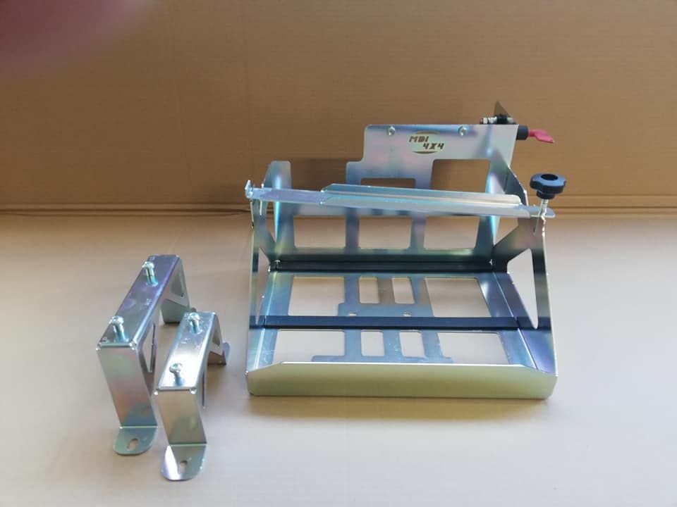

These guys have a nice kit:
COD 4087 SUPPORT FOR DOUBLE BATTERY
M.DI.4x4 Complements for discovery
(scroll to near the bottom of the page)

I’ve been looking for a dual battery bracket solution for a while, have you had any success ordering this from their site?
