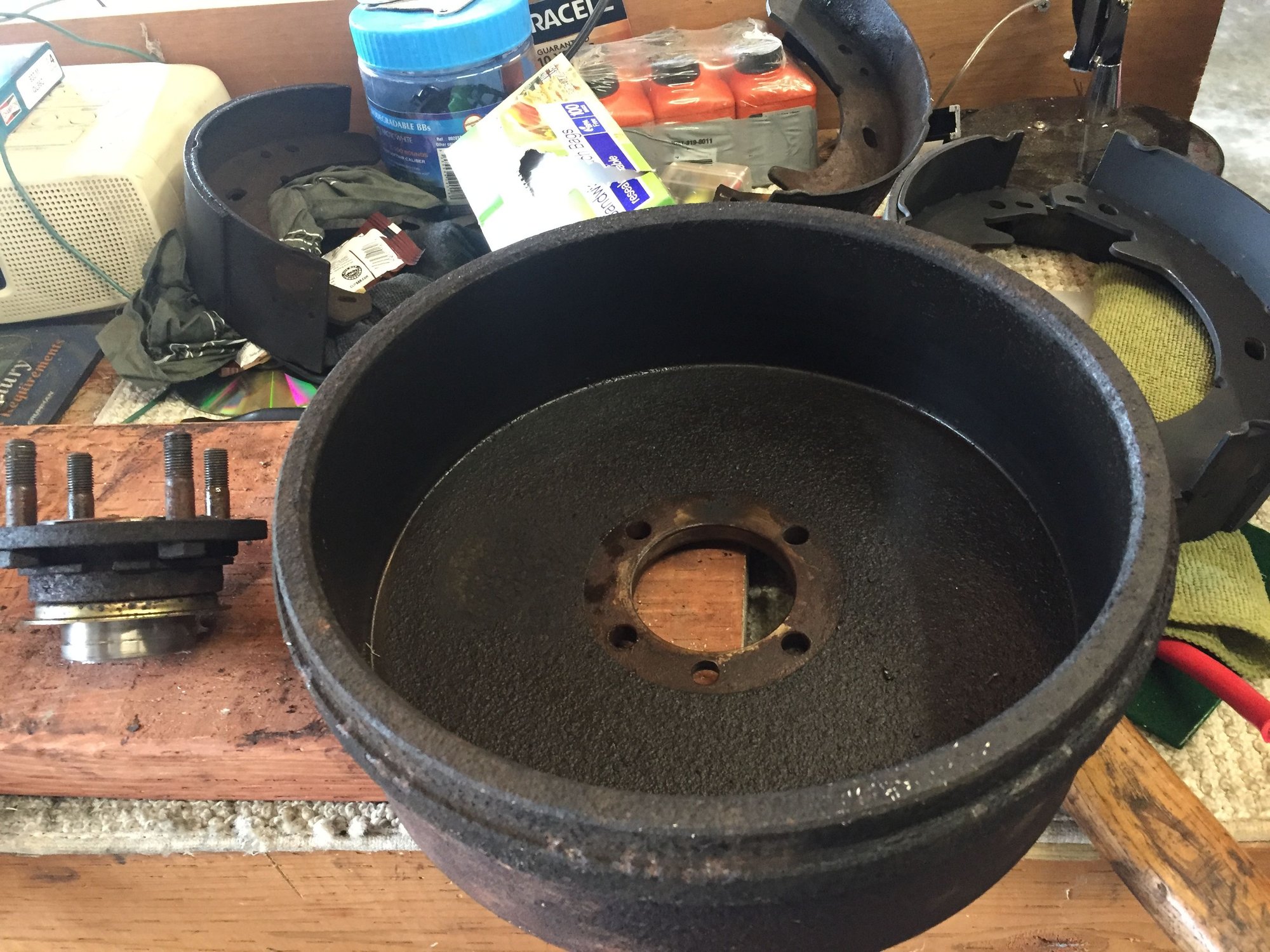

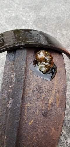

Okay. So finally took it all apart again. The output shaft flange was stuck to the front part of ebrake housing. Separated them and did some preventative for next time. One of the shoes had a pad that disconnected from the actual brake shoe. So once I fought everything back on and fully assembled I adjusted the brake screw to spec and everything worked. My learn for this is that park, forward and reverse only work when rear prop shaft is connected. Wierd part in removing brake housing cover is this snail came out. First time ever removing it. Snail was still alive. Buddy who was under the truck with me said he swore it fell out from inside where the shoes were. Lol.
