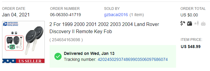

Ok, so I had two trucks in process that I needed new key fobs for. I decided to try the ebay keys and see if I could program them using the forum rental Nanocom. First batch I bought was from this seller:

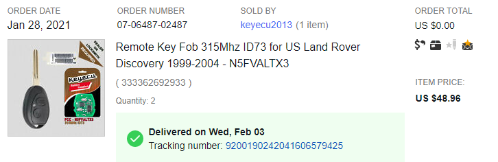

Their keys did not work, so I bought a second set from this seller:
Their keys did not work either.
To confirm it was not the keys, I took one of my existing keys from a different truck and programmed them to the target trucks with no problems. That confirmed both the Nanocom and the receivers were working correctly.

These are what I bought. Could be that they send the wrong frequency, I did not have a way of checking what they actually were. Led's lit up when pressed though.
