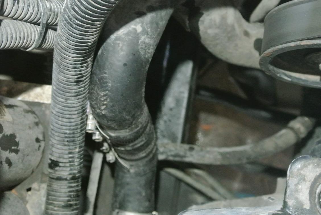

did the inline thing. couple of questions, if any inliners reading.
1. what is with the shroud cutting and extra hose? I'm sure I missed something, but I did neither. are they just another option....pics attached if it helps. e pump will go in original stat spot.
2. temp is getting to 170 and that is it. I put a 180 stant in and double checked it is 180. drilled 2 1/8" holes for air (probably not needed, I have air relieves on both sides) all driving /idling conditions= 170.
`so try 180 with no holes or smaller hole? go 190?
my goal is 185 with the smallest variance possible. so theoretically a 180 stat and the electric pump set at 185 makes perfect sense? that would have my traditional pump pushing flow at 180 and the e pump kicking in at 185 when needed and at shutdown.
` am I missing something? does 180 begin to open at a lower temp and fully at 180?
