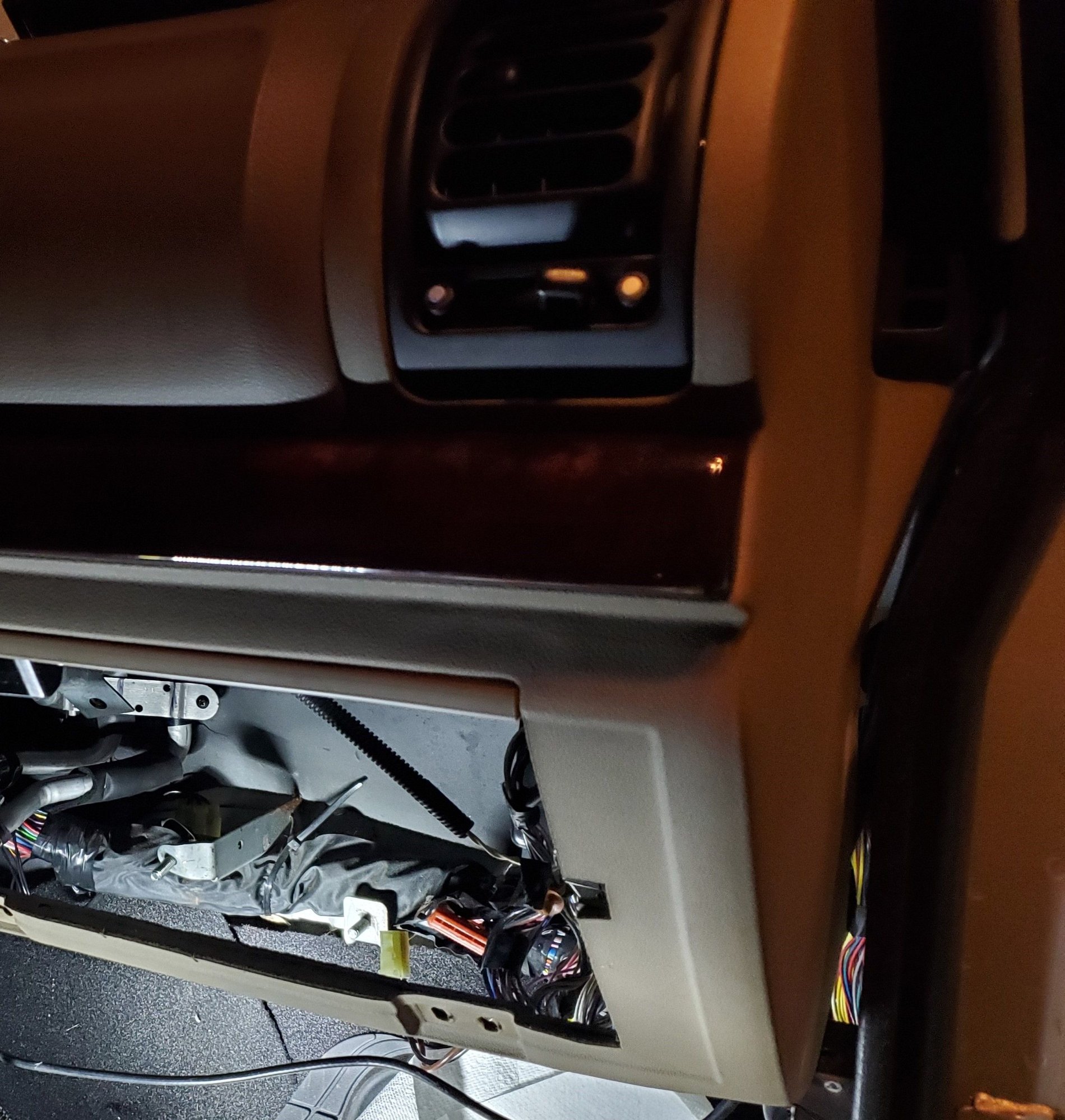

Tiny poof of smoke came out of here.... ( the smoking gun )
Bingo !! Found the issue after months of headaches.

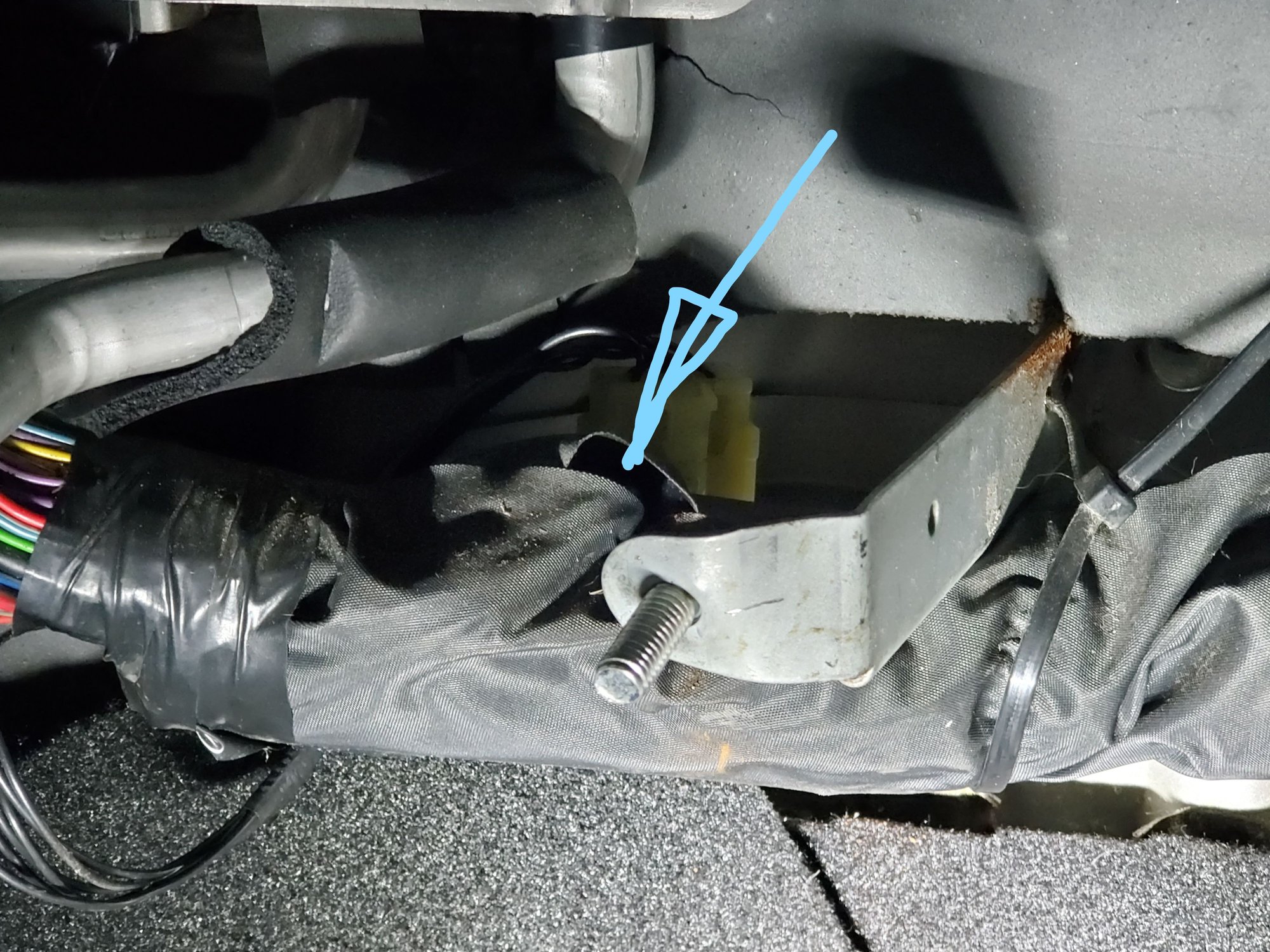

OK - new update. I replaced the fuse box. I found a used one on E-bay. The process was not easy - but I got it done. I plugged it in - and issue remained. Lights still turned on I knew there was a short somewhere as I could smell something burning - just couldn't pin-point the location. I finally determined it may be coming from behind the blower motor - so I removed it ( again ).

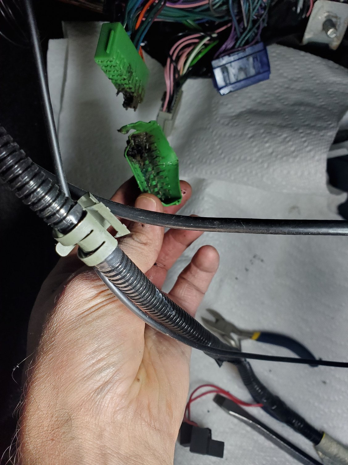

I finally saw a tiny poof of smoke coming out of an opening on the tightly wound bundle of wires. The green header connector was fried. It turns out that I had a small coolant leak and it was trickling down the wire harness bundle and shorting out the headers. The wrap holding this bundle together was creating a pool of coolant. These headers house anywhere from 3 to 6 separate circuits thus creating shorts of all kinds. I ordered some new connectors from a supplier in the UK.

After replacing the fuse box - the Disco continued with the same issues. After relentlessly trying to track down the short, I finally discovered it was coming from a bundle of wires behind the blower motor. There was a tiny leak of coolant in the hose leading into the heater core that was dripping into this wire bundle and pooling, It eventually settled in the header connectors to short everything out.
I replaced them - and just like tht the problem went away!!!
A tiny plume of smoke came out of here....
The connectors were obviously fried.
