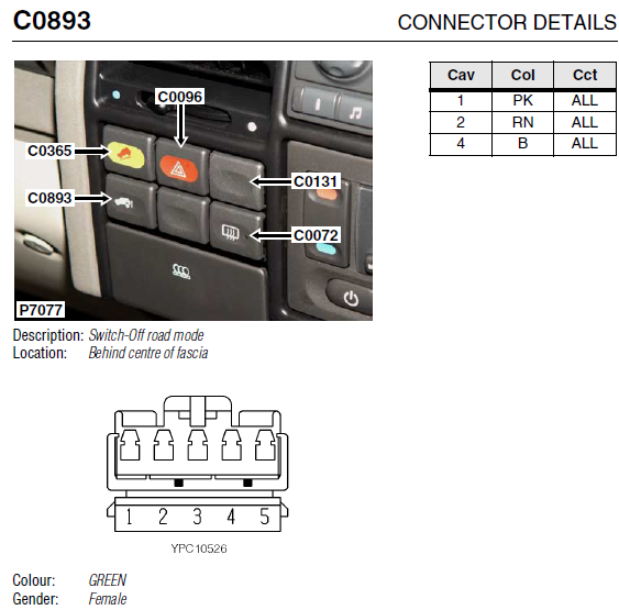

I have a '99 D2 V8. I'm putting the dash back in. At the off road level switch (YUF101751) I have two green plugs that fit. I think one is for the front window heater, which I don't have, and the other is for the height switch.
Both the green plugs fit and both have a pink and a red wire. One has a green wire and the other has a purple wire. My question is which one to use? (I'm thinking the green wire)
I can't test this as I also have the height switch disabled in the BCU after a spring lift.

The D2 electrical library (p 4.68) says that the off-road mode switch is connected to a black wire, and (if I'm reading correctly) a purple/pink wire. No mention of anything green or red. I will try to remember to check what's connected to the switch on my parts truck.

C0893 off road level
I found it in a rave manual, purple, red, black.
Old Jan 16, 2020 | 03:38 AM
mikefitz's Avatar
5th Gear
Joined: Feb 2012
Posts: 5
I had a closer look, the photo I took wasn't good enough. Then I found it in a rave manual. It is C00893. Pink, red, black
Thank you for your help.
