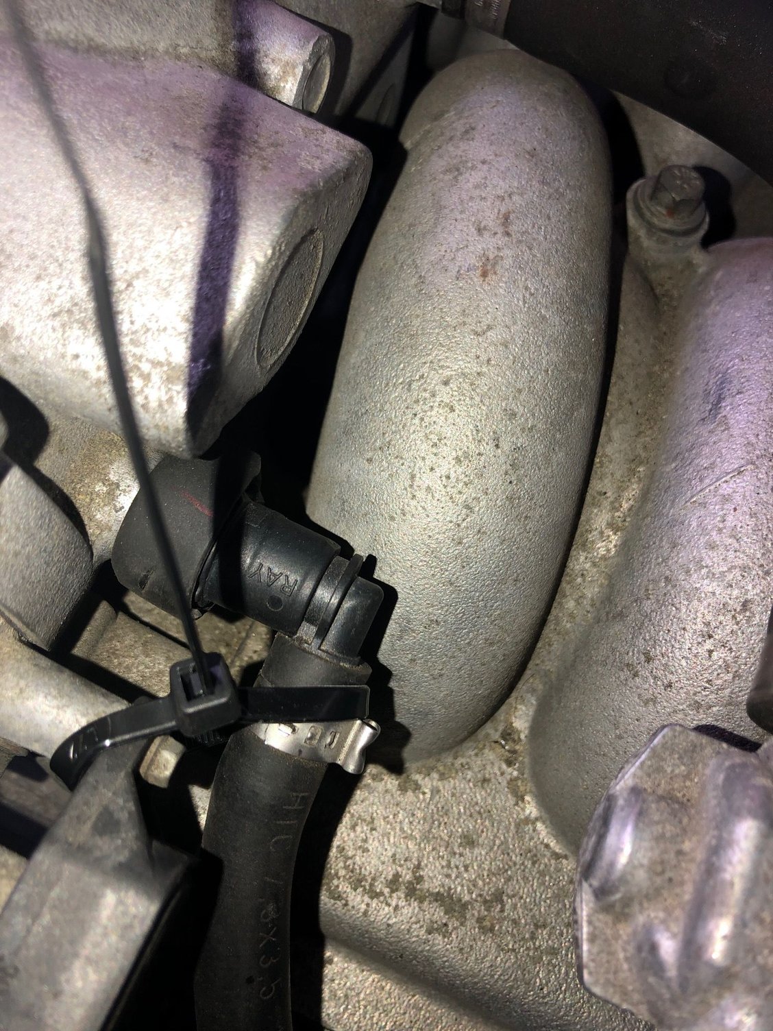

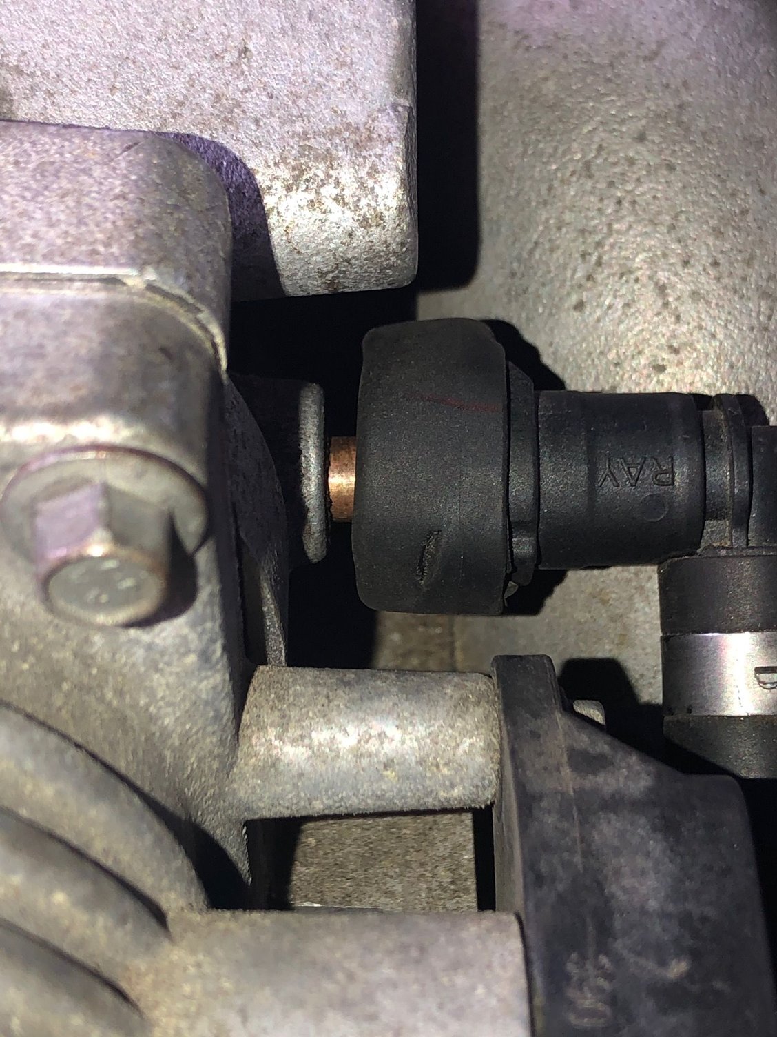

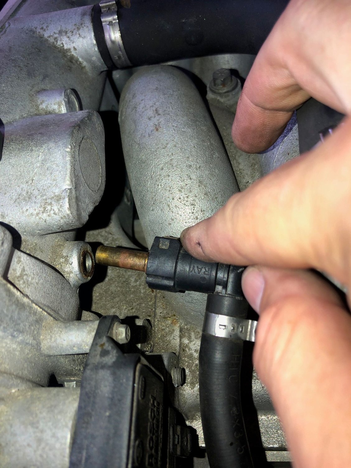

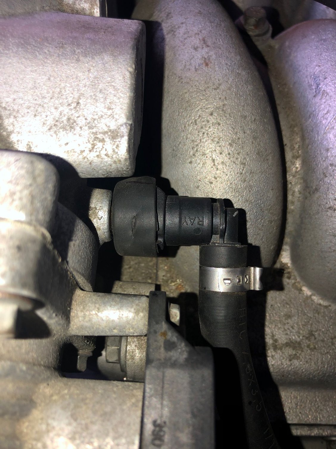

Hi everyone, I just got an AB engine installed and within the first 500 miles I got the dreaded P0414 code (Second air injection system switching valve short circuit). My mechanic knows and thinks it maybe the solenoid or purge valve (which is plausible). I'm taking it back to the shop soon, but in the mean time I was poking around and noticed something strange when I was checking all the vacuum lines in that one of the hoses coming from the purge (or CVS?) valve going into the manifold literally slides right out of the manifold hole. Looks like its not airtight at all. Does anyone know if there should be a clip/washer/gasket or something else holding it in? It seems that if its sliding in and out so easily that's where the leak could be coming from. I put some pics below. I put a zip tie on there for now to hold it in temporarily to see if the code reappears. Thanks for your help.

No that should not come out that easy, mine did not come out at all.

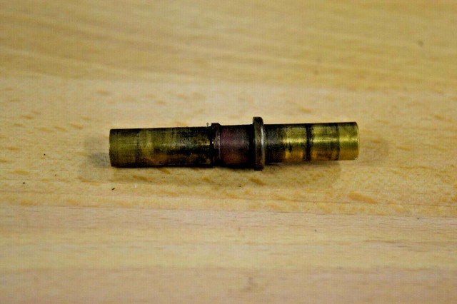

Thanks, Richard, good to know. I dug into this a bit more and I found out its called a "Purge Valve Intake Manifold Brass Port Connectory". RAVE doesn't seem to mention it much at all except on page 30-2-18. It looks like this should be quasi permanently fastened to the intake manifold and the hose disconnects from it. I found a picture on ebay of the same connector. The left side should be in the intake if it helps. Thanks!
