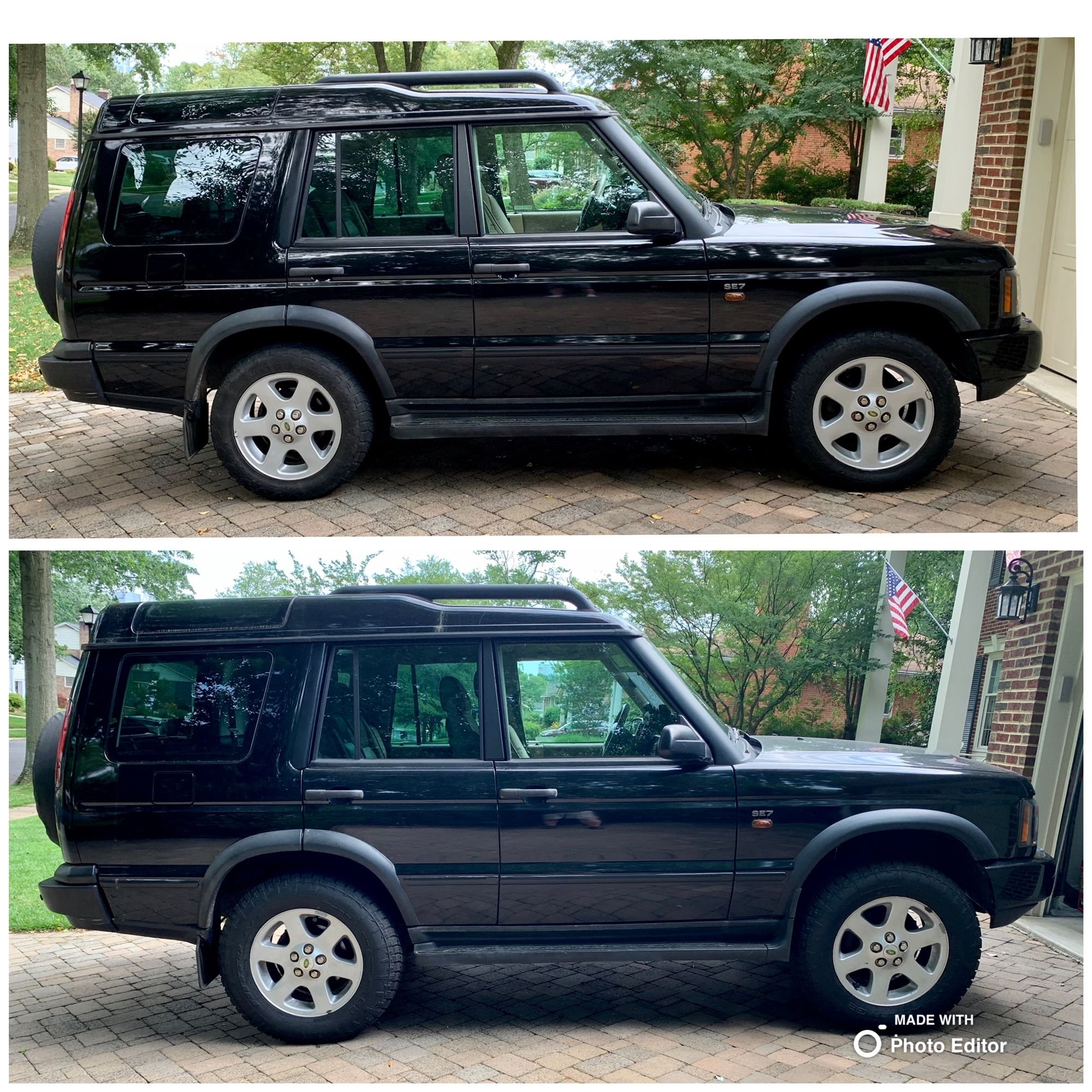

I have a 2 inch lift with 265/65/R18 and I think they are perfect. Only when I'm backing up and turning the wheel full lock do they rub the front mud flaps. Personally, I wouldn't go bigger than this for 90% street, 10% trail. Here's a before (top) and after (bottom) lift plus tires. The front looks a little high because its parked facing up a hill. Otherwise it would sit level.
