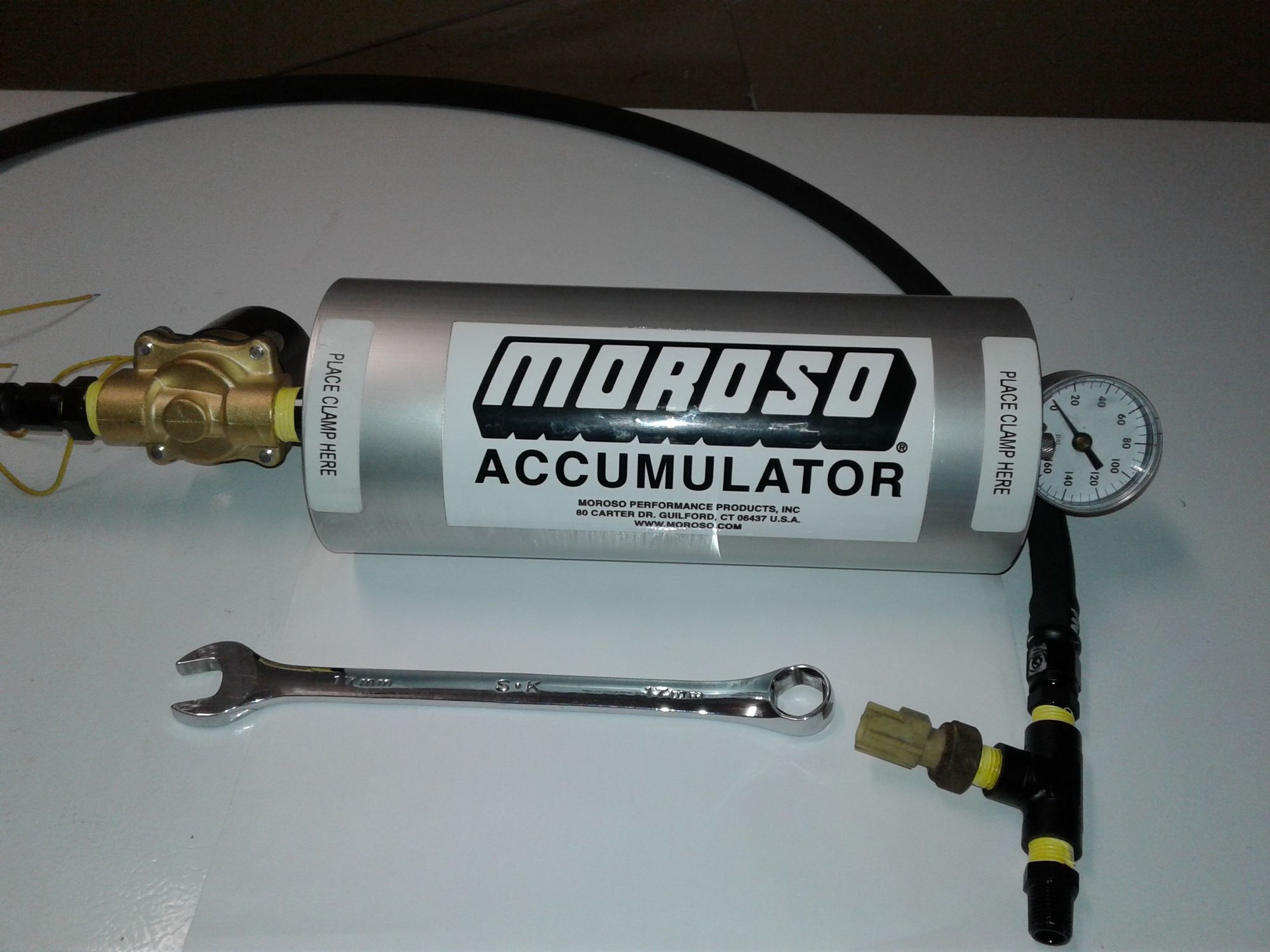

Accumulator, T fitting, electric solenoid valve
Hi all, read the whole thread and I am convinced that pre-oiling and frequent oil/filter changes are the answer to many of the Land Rover's engine woes. I think my 2007 LR3 SE with the Ford 4.0 V6 is infamous for timing chain issues but when I replaced it I installed a Moroso accumulator with electric solenoid valve (timed) to prelubricate the engine for 5 seconds when you turn the key to position 2.You see the oil pressure light go out, wait 5 seconds then start the engine, the timer keeps the solenoid valve open for about 50 seconds so the engine pumps oil back into the accumulator after engine start and then closes the solenoid valve, storing about 1 quart of oil at about 55psi and ready for the next engine start, when the process is repeated. The previous owner of my LR3 (250,000 Km) had followed Land Rover's 12,000 Km oil change recommendation and suffered a blown engine, which when we took it apart was very dirty inside. I change oil every 5,000 Km (about 3,000 miles) and use a Ford Motorcraft filter and Castrol synthetic 5W-30, but also have installed the Moroso ever since dropping in the used Ford Ranger 4.0 V6. I expect that the maintenance/accumulator combination will cause the engine to last for many years of trouble free operation. I installed a "T" at the engine oil pressure sender tap on the block and put the sender on one side and the Moroso connected via AN6 hose to the other side. Is this THE answer? Maybe not, but it definitely works, the engine is never, ever, ever dry started, at oil change time just floor the accelerator pedal to crank up and charge the accumulator, then start normally. Or you could just start it normally, one sort of near dry start every 3,000 miles probably isn't significant...
