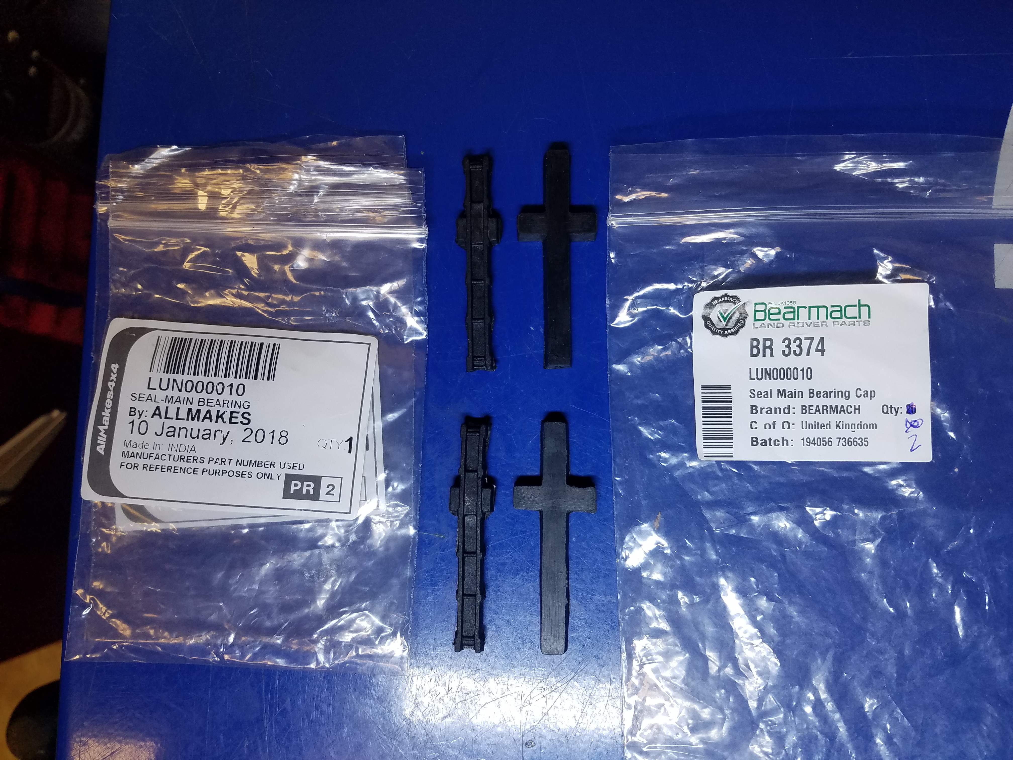

I would consider the Bearmach cruciform seals instead of the Allmakes. $12 shipped on ebay
They are made differently, and after holding each, the Allmakes look like junk that will leak.

That's good info. I'll follow your recommendation.
Thanks guys!
