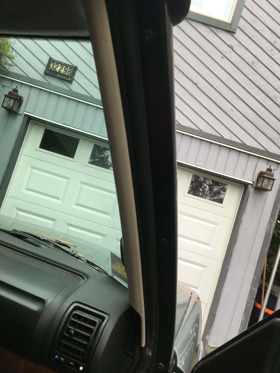

Be very gentle with those windshield bits the tabs brake very easily, I had to use screws to attach mine after breaking the tabs.

3 x #8 1 1/2 screws SS and 3 GM body work rivets. Just needs some black paint, but that is on there solid.
