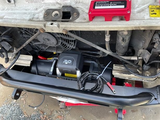

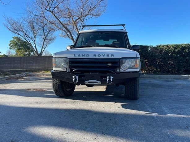

Got the bumper and winch installed.

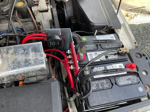

Wired some foglights to the stock wires with a amazon waterproof connector kit. Same kit for the in dash controls for the winch. Could use some cleanup after trimming the cross member so the winch controls would fit. Still havent put the winch rope on, want to make sure i tension it correctly and my driveway probably isnt the best place for that. Dual Battery install went fine, the MDI kit made it super clean. Havent made any progress on my dvd replacement thing, but, otherwise, its coming along.
While the bumper looks a lot better than the cracked/broken stock one that was on there, the water bottle is now more vulnerable, not sure what to do about that at the moment.

The dual battery setup looks great, I didn't realize there is a vendor out there making them.

This is such a clean install for bumper 🤩🤩🤩
Also love how that dual battery looks!
