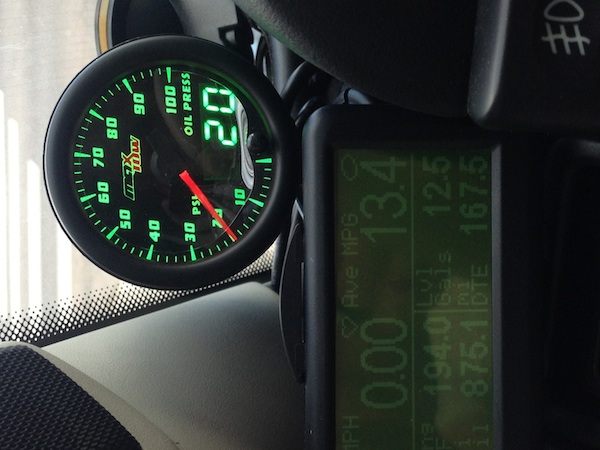

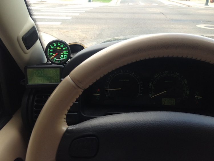

Here are a couple of shots of my combo. Though I can't recommend this GlowShift MaxTow. Even on the dimmest headlight setting, it's too bright.

G150driver,
Where do you have your oil pressure gauge mounted on the engine? In the oil cooler port? Other than the bright glow of the gauge, how do you like it?
Old Sep 12, 2013 | 05:52 PM
G150driver's Avatar
Joined: Nov 2011
Posts: 245
Likes: 16
From: Denver, CO
Originally Posted by JimmyTomahawk
G150driver,
Yes, the sender is screwed in at the oil cooler port, since it is unused on the '03/04's. I can't remember all the exact details of the thread adaptor to make it all screw together, but it's detailed here:
https://landroverforums.com/forum/di...isco-ii-33978/
I like the gauge, as the aesthetic is fairly consistent with the Discovery's gauges. The LED backlight also has a very bright blink to it if the oil pressure drops to zero. That's cool. But I don't think I can deal with the brightness. No rush to find something better, but I'll be looking.
