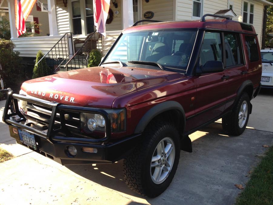

Well after fitting the ARB bar and the Disco is finally running well I am heading up to Rousch Creek this weekend.

looking purdy

nice looking bumper

I need to pull the trigger on one of those these days. Looks great.

Nice job, I love mine. Just curious as to what you did to the front inner fender splash panels. You have to cut them off or they will hang down below the bumper. I did that but didn't secure them and eventually the wind on the highway pushed them up onto the spinning front tires and tore them up. I then removed them but became concerned about road debris, rocks and grit being tossed up into the fog lamps and possibly damaging the windshield washer reservoir and pump. I got 2 used ones and plan to reinstall them with possibly some pieces of sheet metal to attach the lower edge to the lower trim of the bumper.
