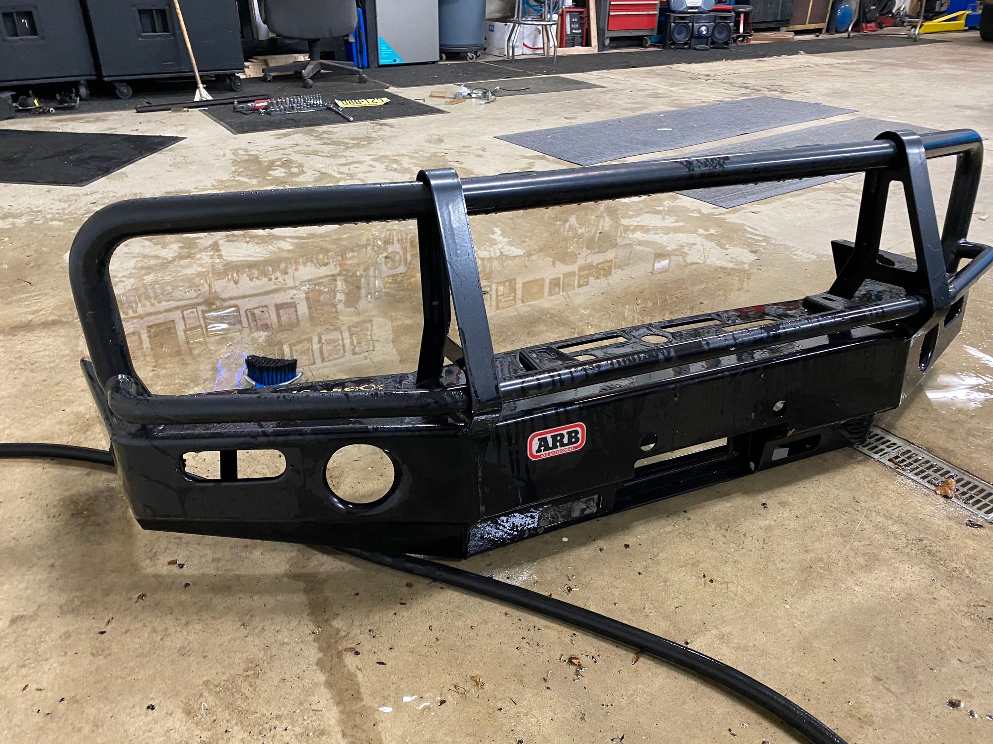

What’s the best way to fix my arb bumper powdercoat without spray painting it. It’s been sitting outside for awhile and is faded pretty good and I was hoping someone had a good suggestion to get some of the shine back. I’ve tried compound polish and wax. I can get it powdercoated for 285$ but I figured I’d see if I can do it on the cheap first
It’s wet in this picture but dry it’s more grey and chalky

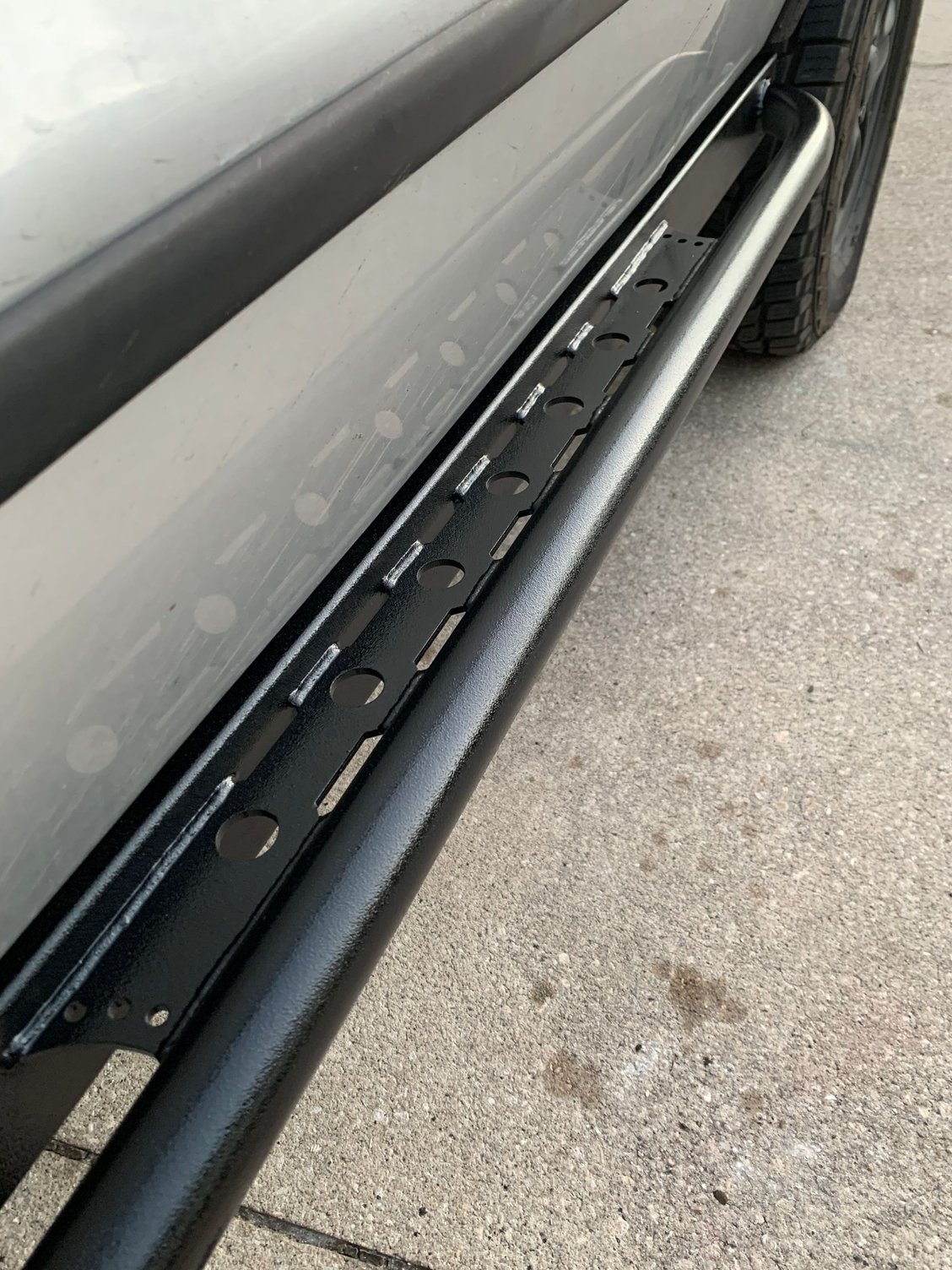

I had really good luck with the herculiner spray can. You can get them at Walmart. Turned out great on my sliders.

I ended up applying rustoleum satin clear and it actually made it look new again. It’s not absolutely perfect but it’s no longer faded.
