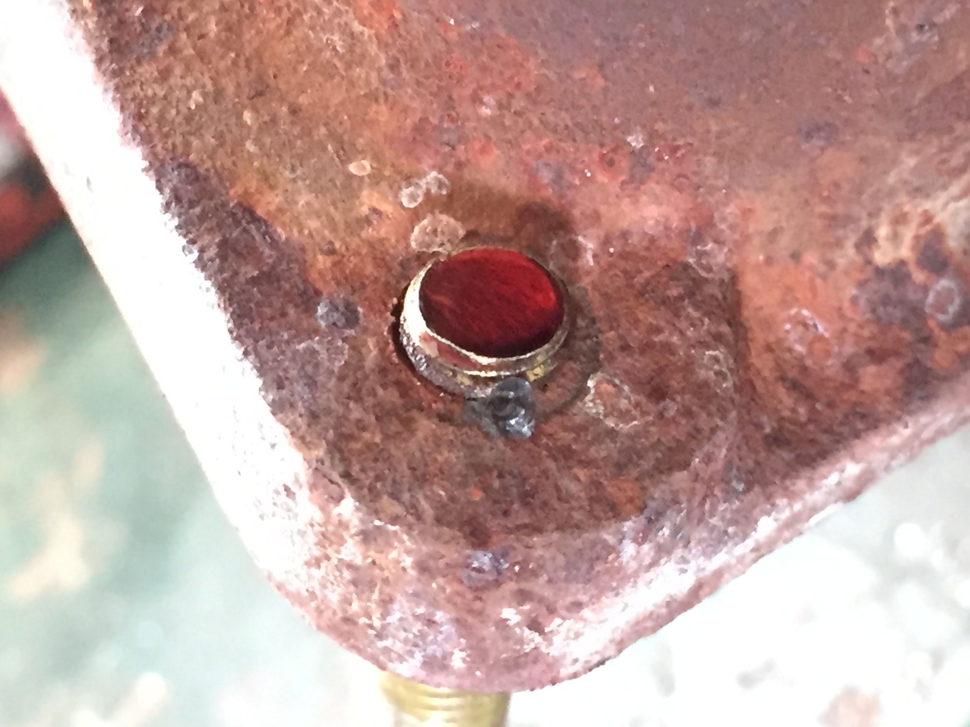

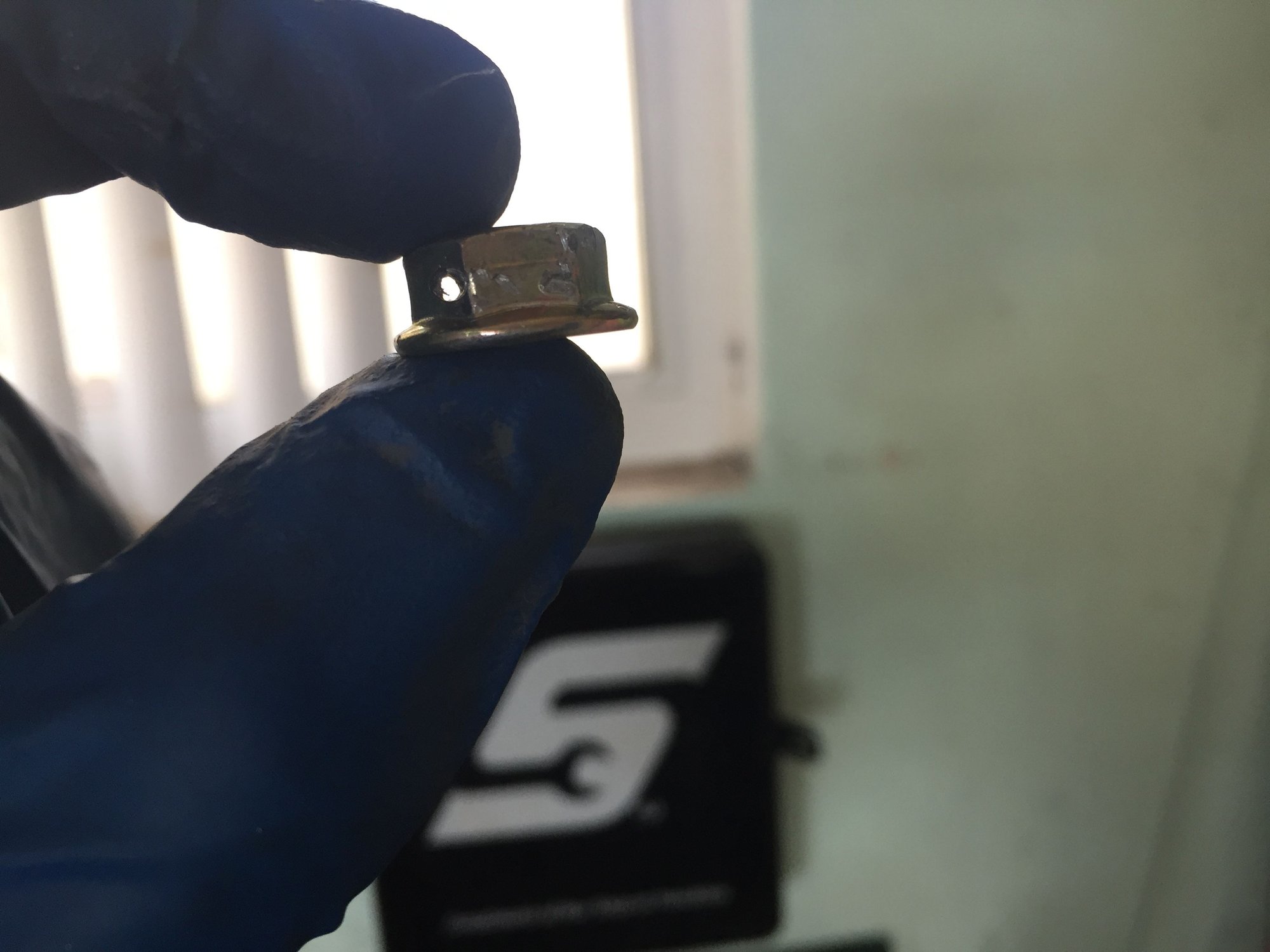

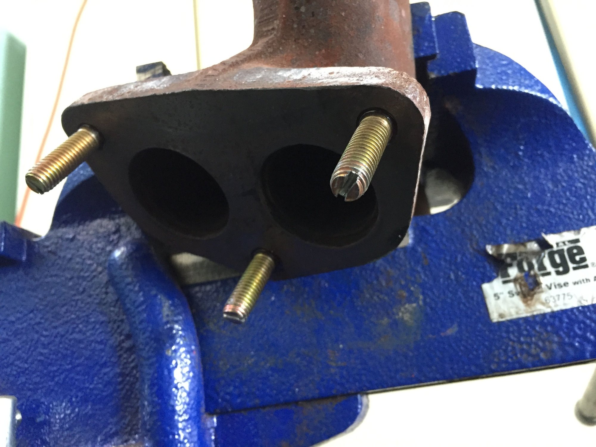

The whole process, from grinding and drilling the stud to tapping and installing is a pain in the rear. I did this to a clients rover. All done by hand, no press.
