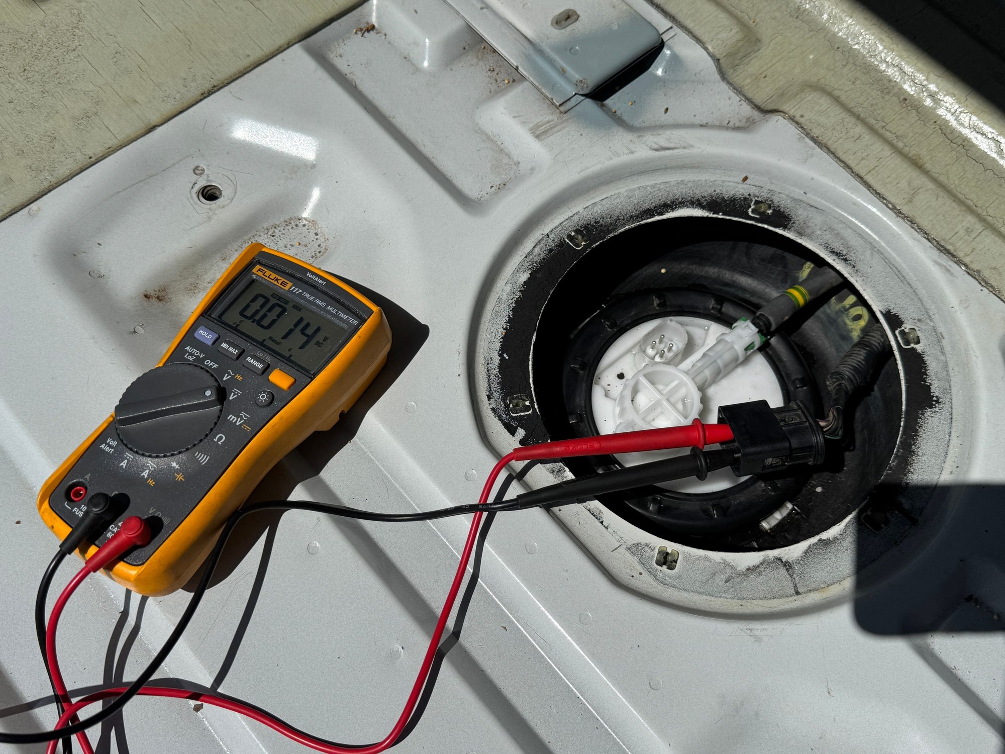

More investigating. I'm admittedly not super proficient in multimeter usage, but did go ahead and test voltage across the pink/white wire and black wire connectors at the fuel pump, and with the ignition on, these are my readings. Shouldn't it be 12 volts?
I checked the fuel pump fuse in the engine bay and it's good. Swapped the relay with two other spares and no change.

Will do! Also despite those MM readings, when I crank the engine I can hear the pump energizing. Maybe I’m just reading it wrong.
