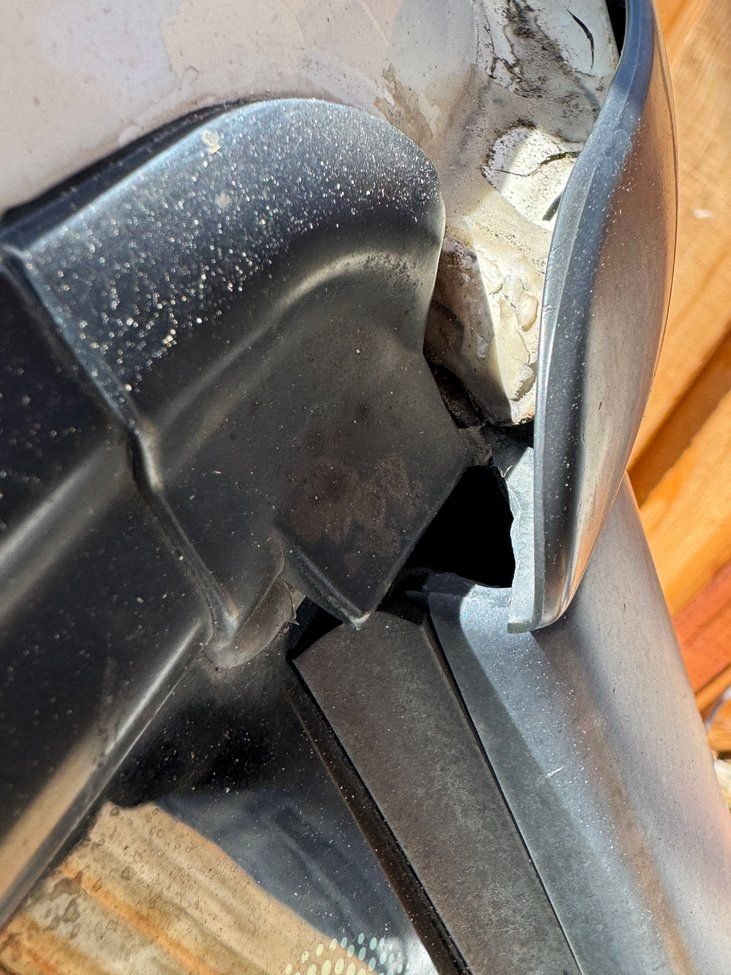

Wanted to follow up that another issue was found that was contributing to the rough warm starts. Check out my last post here.

Wanted to follow up again and mention that I think I found the reason the circuit board had a moisture problem. The little finishers at the top of the A-pillar looked like they were just fine but upon closer inspection realized they were missing the ends that prevented water from draining behind the A-pillar trim, which meant on particularly heavy rains, some might've gotten through to the cabin and onto the fuse box.
See this post here to catch up on the issue and see my fix: https://landroverforums.com/forum/di...m_content=post
