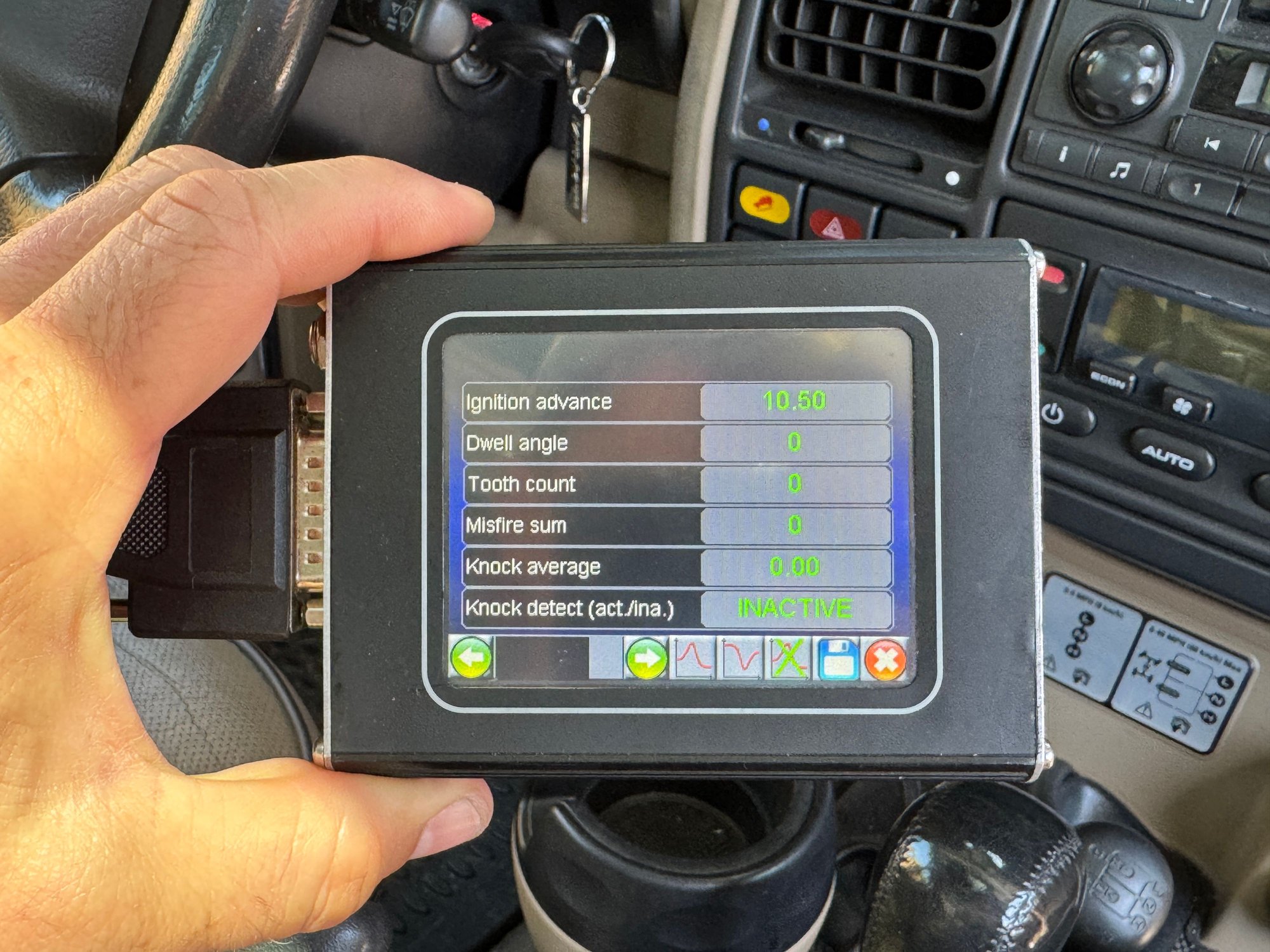

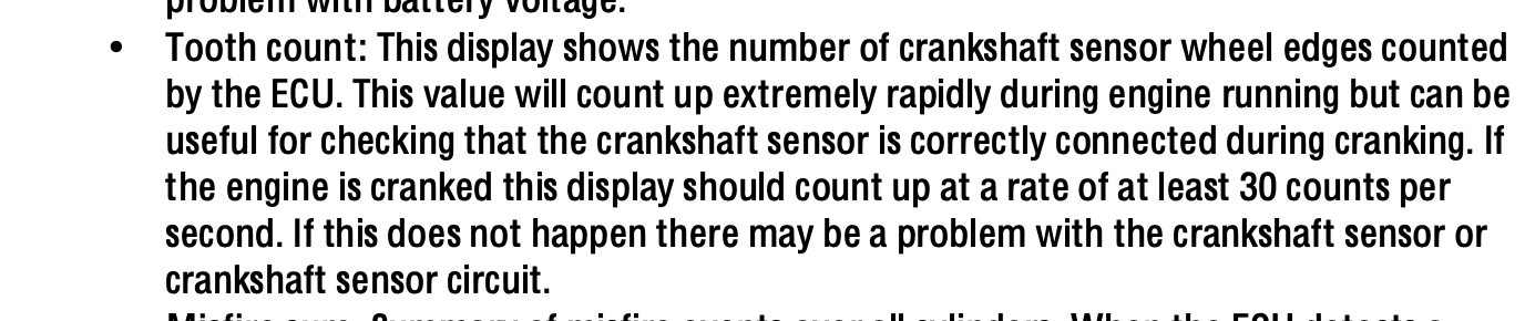

Just another data point: I was reading through the Nanocom manual and noticed an output variable they call Tooth Count. I cranked the engine over with the NC plugged in and the value didn't budge from zero. Assuming I conducted this properly, it should've I think? Here's the excerpt:

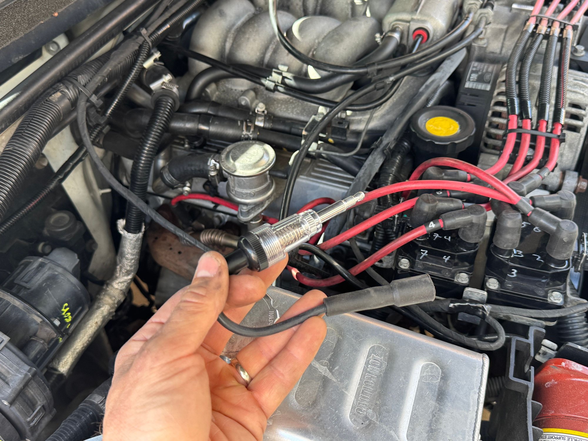

Alrighty, just tested cylinder 6 and 8 for spark and neither made any glowy action happen while cranking over. I didn't bother testing the rest.
