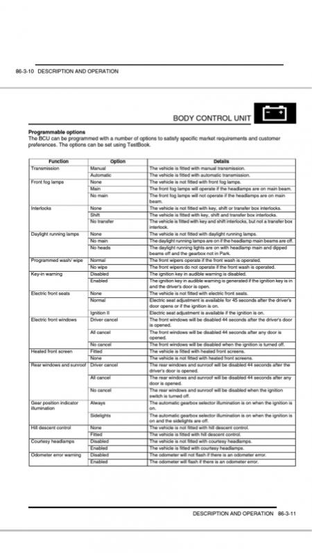

My nanocom can read and sync the miles, but it is true that the miles can only be synchronized UP. Which ever device has the lowest miles will be updated with whatever has the highest miles.
Another option is to just edit the setting in the BCU and turn off the warning. The miles will still not match, but the odo won't flash. Nanocom or hawkeye or others can do this too.

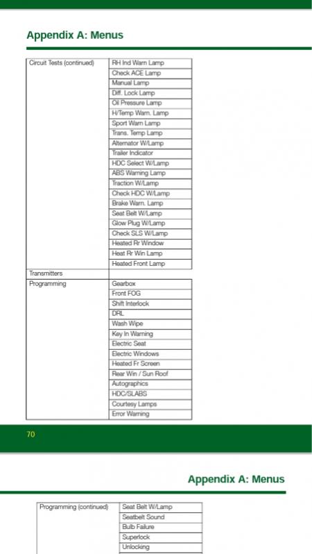

Originally Posted by bcolins
Can I get you to explain this jafir? BC
You just go into the BCU settings on the tool and turn it off. I think hawkeye calls it security or something.
It's at the bottom of this page in rave:
And here is the hawkeye manual page:
