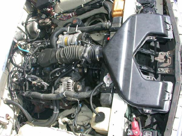

Unable to find that Astro van adaptation on a forum search. By the way, my other car, a 1962 Caddy has a 4.3L '97 Astro Van engine + tranny 12 years now, and such clutch fan too. The best thing I have done to an old car
Edited- added: Thanks, Buzz. I was typing while you posted. It is not mpg, is peace of mind. Plus the paranoia !
