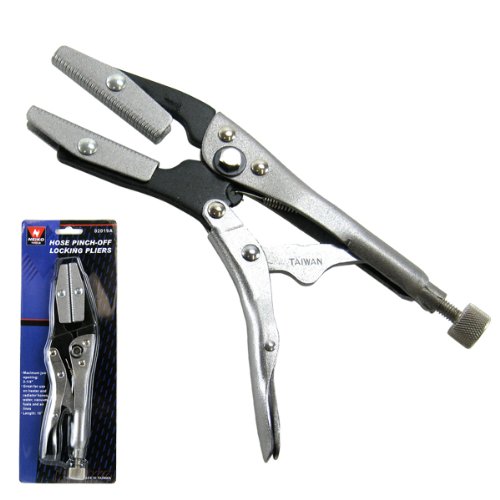

Great project. I am anxiously following your progress here. I would like to do something and have mine cooling more efficiently as well. Harbor Freight sells these radiator-hose vice grips that I bought so that I can swap hoses, thermostat, radiators without constantly having to drain/refill/bleed the coolant.
Attached Thumbnails Flex-A-Lite 180, Motorad 180 Thermostat, Evans Waterless Coolant experience-radiator-hose-pliers.jpg
